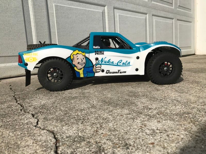

Since there is no Baja Rey pic thread, I guess I will post these here. Got a body painted by a great painter over on RCtech.net. It turned out awesome.

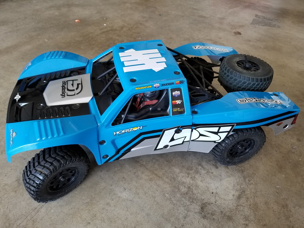

I really can't believe how much better the BR drives compared to the Yeti Score. For some reason I gave my BR to my brother in law and wanted to build a new Yeti Score because of all the customization. Had it for all of a week threw in a Mamba X w a 3800kv sensored and it flew like a bat out of hell. However I just hated the way it drove thinking back fondly of my BR. So sold the entire kit and got another BR and even in stock form it's just a vastly superior platform. Here's my quick and dirty paint job over the top of the red stock scheme. Just sanded it down a bit and threw on some matte finish. Not bad for the stock body.
It's good to be back. Ordered the SSD Third Member to fix the rear end issue and I'll get some aluminum trailing arms when they are back in stock.
The new paint job, replacing the already scraped off black/gunmetal paint above:
