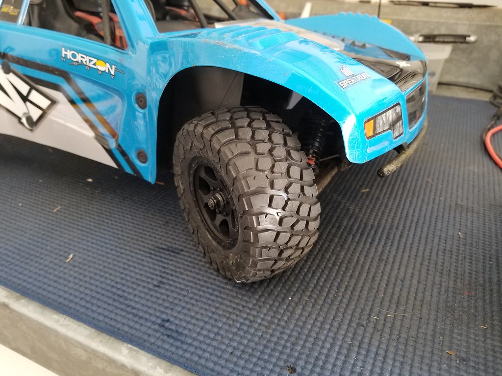

Some new shoes...the Baja Claw Mickey Thompsons ballooned way too much. While being closer to the stock size, I just hated how soft they were. So got some Proline KR2s on DE Racing Trinidad Wheels. These wheels are perfect...no offset and work w/ the brake calipers, which a few sets of wheels I've tried don't.
.2 mm shorter but .2 mm wider overall. I like the way this combo looks too...much better than stock.
