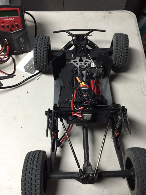

Also working on some solid rear links.
Let us know if those uppers work cause i see a light bend in my stock uppers from my son crashing yesterday. First real dirt testing yesterday as ive been tied up with work and other things and i gotta say this thing is a beauty compared to my yeti score truck. It seems to float over the terrain much better than the yeti.
Sounds like a good idea. My plastic links are holding up fine, but there's nothing wrong with making them stronger. (unless they end up transferring force to a more expensive part, of course.)

Upper links are good to go!! Makes the rear end Solid, hard to explain but it is firm, not flimsy. Only thing you have to do is add some .015/.016" washers/shims to each side of the pivot to take up the .038" gap difference in width. The dude that I got the idea from ran them as is and I personally don't recommend it, to much play in the rear end. The servo saver mod work beautifully. I added a .026"thk washer between the aluminum brace and the upper servo saver mount and a .013"thk e clip between the upper servo saver mount and the bearing. I get no vertical play at all and steering is just so solid now as well with stock servo and added an aluminum steering horn. I have a savox 1258 in the tool box on call as soon as this one craps out but I have absolutely no complaints on stock servo up to this point and has not failed even after hitting a couple curves [emoji15]. I also removed the fans out back and replaced them with a 3/16" o.d. Ss rod taped at both ends 2.5x4.5mm tap and tig welded a small tab for the on and off switch. Doubles as a solid carry handle as well. I have a full list of mods/upgrades I have done if anyone is interested, most I have picked up from here and some from what I seen and liked and din't like. Tomorrow will be shock and suspension tuning. Going to start with a simple oil upgrade to 35wt and set ride height and hopefully, crossing my fingers go for a shake down test to a local spot from way back, hope it's still their and in decent form.

I like the rear links but do you think they will hold up? I see you only have the rod ends screwed down half way. I went to my LHS yesterday and was about to pick up the same setup as you but saw that they were a bit short. Your pic now confirms this. I realize i could sleeve the remaining thread with a spacer but im concerned that with not enough "bite" they might have the tendency to pull apart on a hard hit. Please correct me if im wrong. I really want to try it out.
Well I dint measure the actual threads on the shafts themselves but I did measure the amount of threads exposed in an effort to get both links as close to factory as possible and as close to each other as possible. That measurement yielded .130". I don't think it's fair to say their in about half way because their is way more than 1/4" of threads on the shaft so my best guess would be their about 3/4 of the way in making the threads about 1/2" on the shaft and sounds about right if I remember correctly. I will be doing some bashing around today hopefully and let you know. I have about a battery on this new set up and it's unreal how solid the truck is now compared to stock and that's with out a cage and a solid support added in replacement of the rear fans. So I can only see it getting more solid when I throw the cage back on today. The stock upper links I could squeeze while mounted on the car and have them almost touch each other in the middle, I tried squeezing these new ones with my finger and they maybe moved like .020" and that's squeezing pretty hard. I'm pretty confident with the new links. Plans are to make some new aluminum upper links down the road when I get some time.
I hear ya! Im debating on either your method or sleeving some all thread from the local hardware store and using revo rod ends. Im sure either way is better than the stock plastic links. yeah let us know how they hold up. Thanks.
Tuned the suspension today and gave it its first official bash session. WOW... This truck is incredible what it can do. I've had a sct, monster truck and buggy in the past and absolutely nothing compares to this thing. It will literally eat ANYTHING you throw at it. The new upper links held up beautifully. Going to go ahead and install the savox servo, not because of failure just want to be clear it has held up fine and has done its job and still is but because it's not enough servo for this truck as most of you have pointed out- thank you for that, motor heat sink fan as a preventive.
