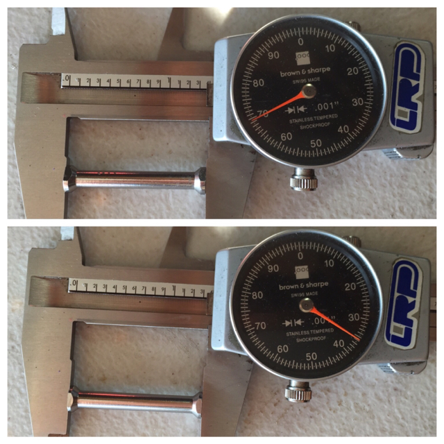

As for the steering vertical play, this is what losi sent me. The smaller post. I still had to run the eclip behind the bearing to eliminate some of the vertical play on the threaded tower.
