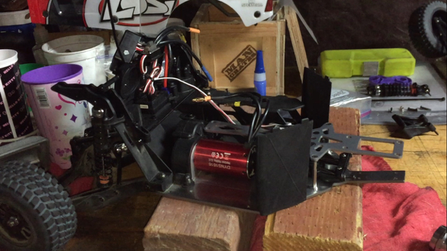

Replaced the stock electronics. Kept the motor though, it will do fine until I can get a 1/8"-to-5mm adapter for the pinion gear to use my preferred motor.
The ESC is now mounted lower. (the old ESC is set in-place for comparison's sake.) Probably doesn't affect the center of gravity that much, but it makes me feel good:
The truck steers much more precisely with the Hitec HS-7955TG servo and the TLR aluminum servo horn I installed, and the SkyRC ESC has typically excellent motor startup, with none of the cogging that the Hobbywing ESC exhibited. The HS-7955TG servo is much faster than the stock servo, so the gyro can correct the truck's steering without making it wiggle like an old Cadillac with blown-out shocks.
I didn't have any 20K oil and I was too lazy to mix some up, so I put in 30K oil instead. Based on what I saw when I opened the center diff, the 30K oil should shear down to 20K pretty quickly anyways. So, 30K oil is good for popping wheelies on dry concrete, if there's anyone looking for that kind of action. I left the front diff completely open because it still handles corners better that way; just thickening the oil in the center diff improved acceleration off-road quite a bit.
I noticed a longer runtime with the new setup. Not sure if it's because I'm not using the cheap Hobbywing ESC anymore, or if the 30K oil in the center diff is keeping the truck from wasting power; probably some of both.
