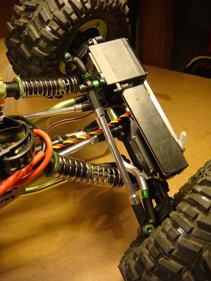

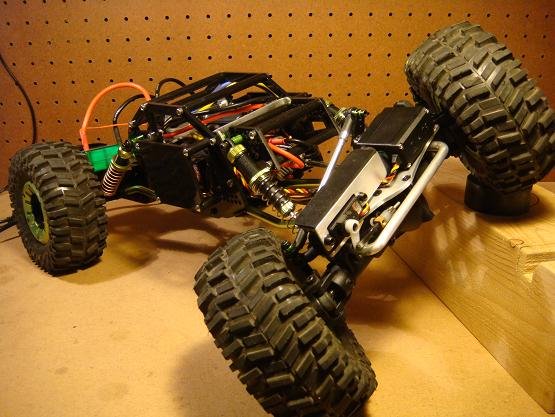

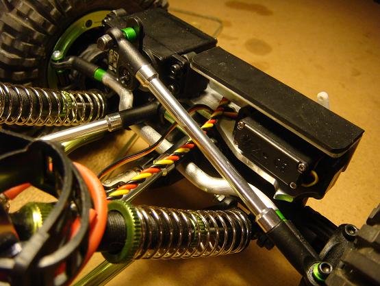

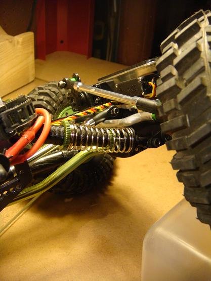

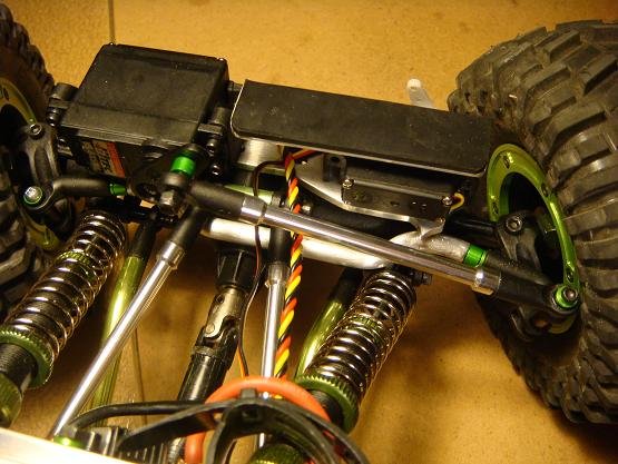

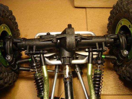

so, spent last night finishing up my BTA steering mod (pics below). i'm liking the way it turned out and can't wait to get it on the rock pile. i figured i could do the same as the ckrc kit but instead of spending $50 it cost me $3 for 3' of 1/4" aluminum rod. after 4 attempts and some trashed rod i have no binding at all and everything is lined up awesome. it is tight but fits if you bend it at the right points. i also add a nerf bar on the front to provide some protection to my diff lock servo and back of the steering servo. next up, 4VP chassis :)

looks good man,,,,action pics are next right?

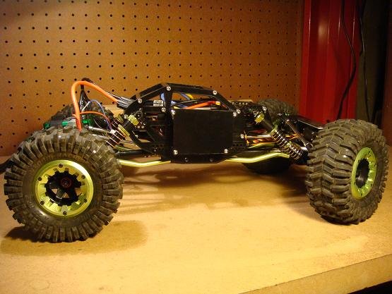

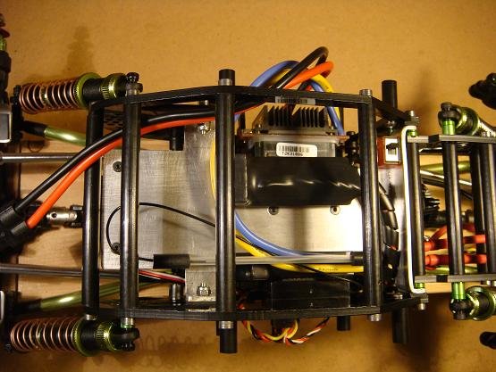

ok. put the kids to bed early and spent the evening getting my crawler up and running. 4VP chassis, custom made aluminum backbone (adds a little extra strength to the chassis, ties the top of the transmission to the chassis plates and gives me a little room to mount things), BTA steering mod, front diff lock option, dig unit, rear axle saddle pack. i still need to get some lexan to cover things up but i'm loving it! low CG (although a little wide in the middle) and plenty of articulation. once i get the short nose pieces on this thing is going to look as awesome as it runs. a few pics on the workbench. hope to get on the rocks tomorrow.

All I can say is wow!!! I thought about rasing the doors like you did, but I wasn't sure how it would look. That think just looks pissed off!!! Totaly awesome. That short nose looks a little diferent but not a bad temporary fix. I'll be sure to get those cut next week as soon as I get paid and send it out to you. I love it.
