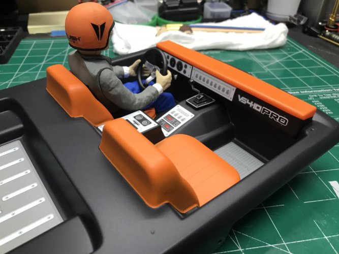

I like the poop brown! Reminds me of a baseball glove. But I second Jason’s recommendation. I always hit the interior with a quick matte and it takes the shine out and makes it look more like fabric/leather.

I also agree on using a flat clear. I use the Tamiya PS55 Flat clear on all of my interiors.

Interior looks great!"thumbsup"
The black that is showing through gives the dash some depth and looks good! You couldn't of planned that any better!;-)

Your interior looks great!
You could hit is with some tamiya flat clear. That should tone down the poopiness a bit and make it look like a bomber leather interior. Just my 2 pennies.
