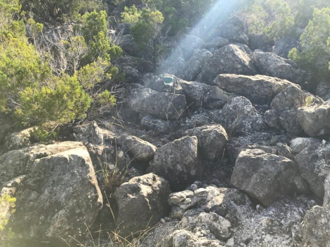

I snapped a few pics of the area in quarry I went to today. This was my first time crawling this spot, and it was fantastic. So many obstacles to choose from, from very challenging to relatively easy. There are also plenty of 'trail' areas, though that's not really my primary interest.

Nice bunch of rocks right there. Glad you’re having fun with this build and looking forward to seeing the axle swap.
The best part is, there is ~16 acres of those rocks in the quarry...:D

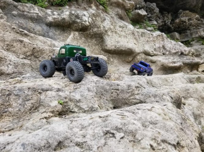

Saturday morning at the big creek was awesome! We did a lot of crawling, and had a blast.
