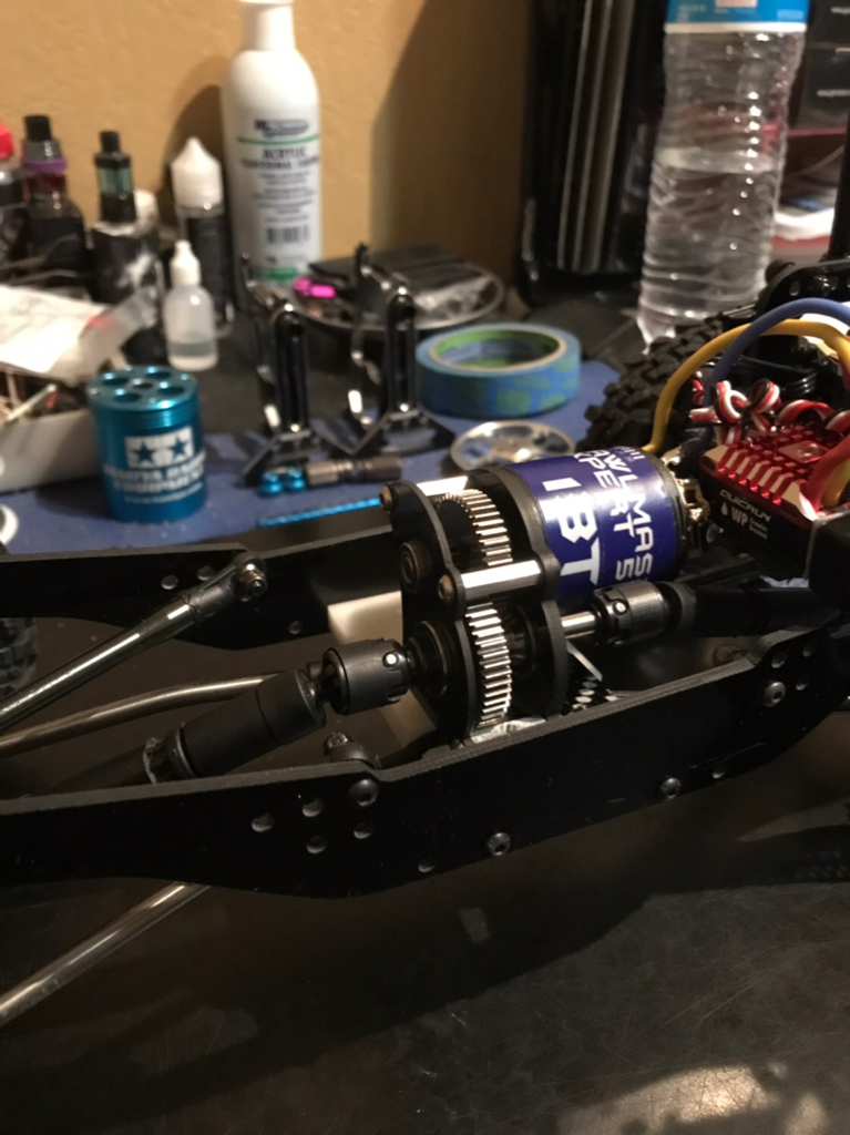

Instead of starting a new thread I’m going to post my new build here.
The latest craze in my area is a lite weight class 1 size tire rig with insane HP. I’m going to try and attempt to build one. I want to keep it under 3 and a half pounds.
Starting with a Team GSPEED V2 chassis and a Raw Builders Kit.
I got it all mocked up just figuring out what to order. I will be using the one piece axles that’s all I know so far.
Any help with a lite weight rig is much appreciated. Never built one before.
Haven’t posted much lately. Waiting for parts for the lite-weight build. My Dlux Ham Berger transmission came in. Was able to install it. But that’s it.
Very nice setup so far. "thumbsup"
I'm working on the lightweight build concept too but in more of a C2 style. I went with the Brazin G10 chassis and Dlux trans then 3D printed my own bumpers and sliders, that whole setup only weights about 2 oz more than a bare set of Axial rails. It is a different sort of fun trying to cut weight to the bare minimum than the typical 22 lb all brass truck rolling around these days.
The thing I found that can widely vary in weight are tires. For example, PL Hyrax with PL 2 stage foams were about 2 oz less per than the Voodoos (with no foam) I planned on running. That is 1/2 pound of weight just based on tire choice.
Also, there is a bunch of weight to be saved with electronics. Switching the servo and ESC to something with a plastic case could save quite a bit of weight. Also since the truck is going to be so light, it will be easier on the battery so a smaller pack could be used and runtime will still be respectable. Buying new electronics has a pretty low weight reduction per dollar spent return but it is something to look at if you maximized everything else.
