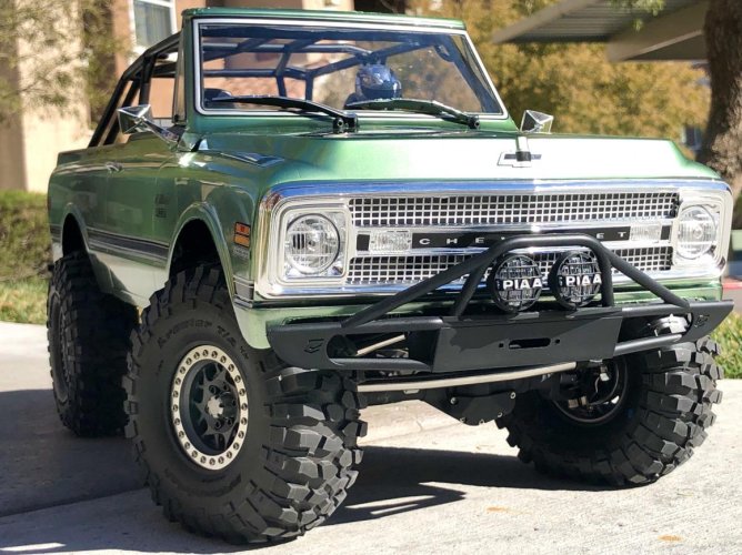

Looks amazing. Is that a decal or a badge?
Hopefully the sun is out because I wanna see this!
Thanks Brandon! It’s this metal decal from cchand, their blazer selection is nice

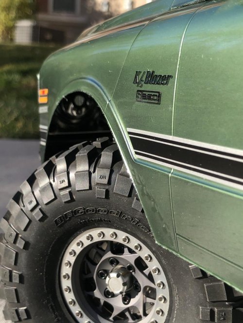

Just got done taking pics! "thumbsup"
Passenger side is the one that shows some ghosting. I could only find one can in stock of this color and wish I had waited for another but it’s not that bad in person.
I'm glad the sun came out today! It looks awesome!"thumbsup"
I'm really liking the color. Gives it that retro look just like it should look like.
I think the passenger side looks OK. A little "red" rock rash and nobody will ever notice!;-)
