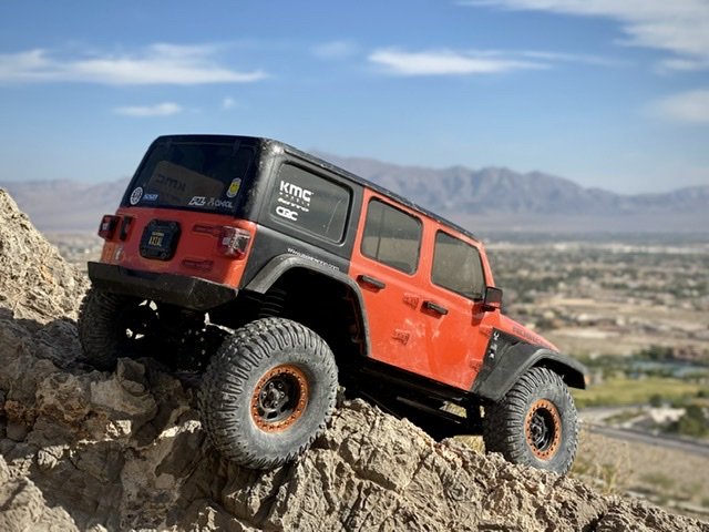

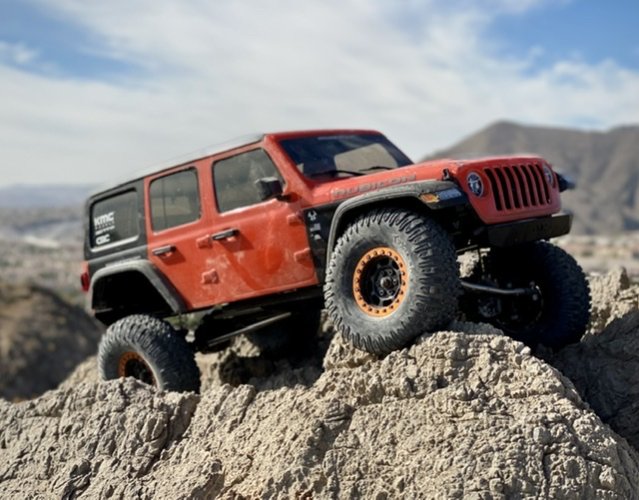

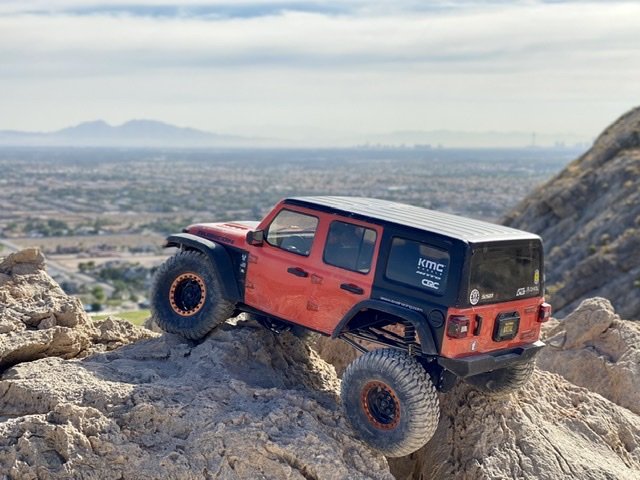

As always, plans change and new ones are made. You may have read in the scx10iii thread that I’ve since sold the 10.3 as a slider and kept the body. I decided to take a stab at mounting the JLU on the vs4-10 without body posts.
The front was a piece of cake. The mounts are separate pieces for the front, and simply screw into the chassis/bumper mount on the outside of the rail. These lined up well with the holes on the chassis already, to a point. The main hole is the only one you really need (twss) but if you wanted more than one screw holding the body mount then you’d have to tap a new hole in the mount or the rail. It’s plenty sturdy with one screw so I didn’t bother.
The rear was a different story, the whole bumper mount receiver box and brace are all one big piece on the vs4-10. The axial body mounts in the rear are actually integrated into the bumper mount, unlike the front where they were separate. To use the axial mount some chopping would have been needed so I looked for alternatives.
With the interior in, it sits right on top of the shock towers so busted out some trusty shoe goo and stuck some magnets on the body post towers and underneath the interior of the JLU body. These magnets are very strong but I have no problems pulling the body off so hopefully it will last.
On a related note, I ditched the 12” wb and went for the 12.3”. Lookin forward to driving this one again.

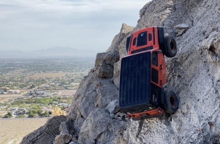

Spent some time with this rig today and almost lost it forever :shock:
It’s been a while since I drive this one but I had a lot of fun. it’s quite different driving this than it is the flat rail chassis builds but the challenge was fun, with the weight of the body and all.
Here’s a still photo of the moment I thought it was all over, and a clip I caught of the line.
