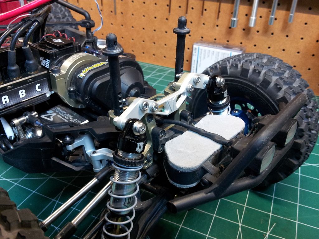

The new VP sway bar is both beautiful and well engineered.

I have wanted to run a spare tire for a while now, but i don't really like the stock location. It feels a bit too far forward and covers up the body clip and kinda blocks the rear lights. So i installed it all the way back and used some Yeah Racing straps to keep it from flopping around. I am really please with the look, now i just need to get another OMF wheel for it!
very good, tho i admit i don't have a ton of hours on this truck. Earlier today i had all the shocks off and they were snapping in and out as tight as new. Been collecting some very cool new parts over the last 6 months and i have finally found the time to get them installed, so i will have some updates soon"thumbsup"
