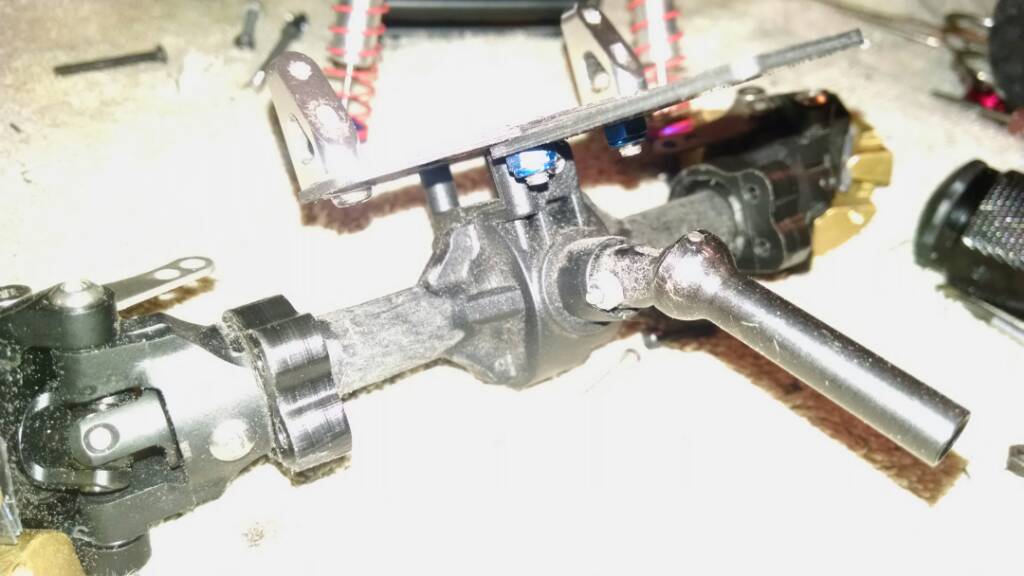

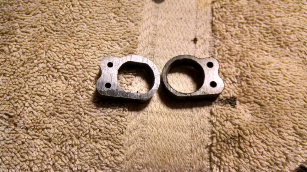

I cut a bearing width off the C's.
Then cut the bearing pockets off. (DravTech adapters for show)

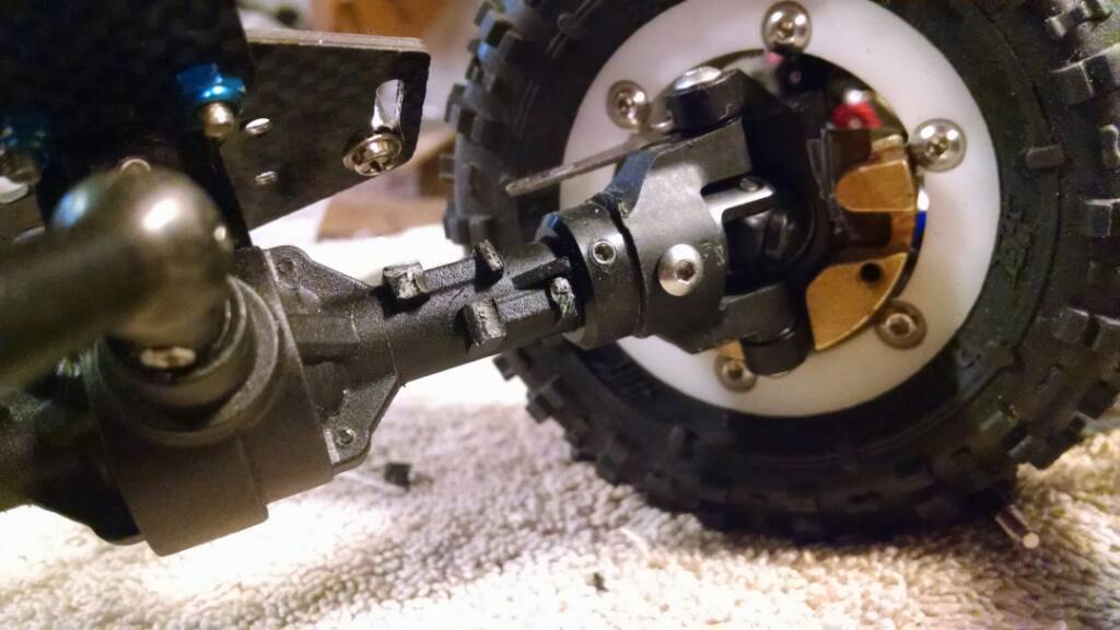

That lead to cutting the shafts down and shaving the tangs.. I think I screwed up tho.. There is way less slop now, even less then my own rig.. Hmmm.. I guess I should shave more!

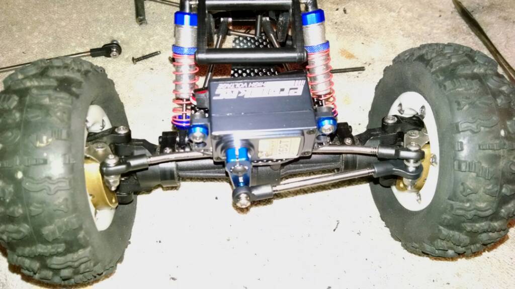

The track width was brought into 7 ¾".. Then I added 1/16" spacers to each side.. The tires where too close to the rod ends..
So after cutting all that, now the tie rod and drag link don't work.. :/

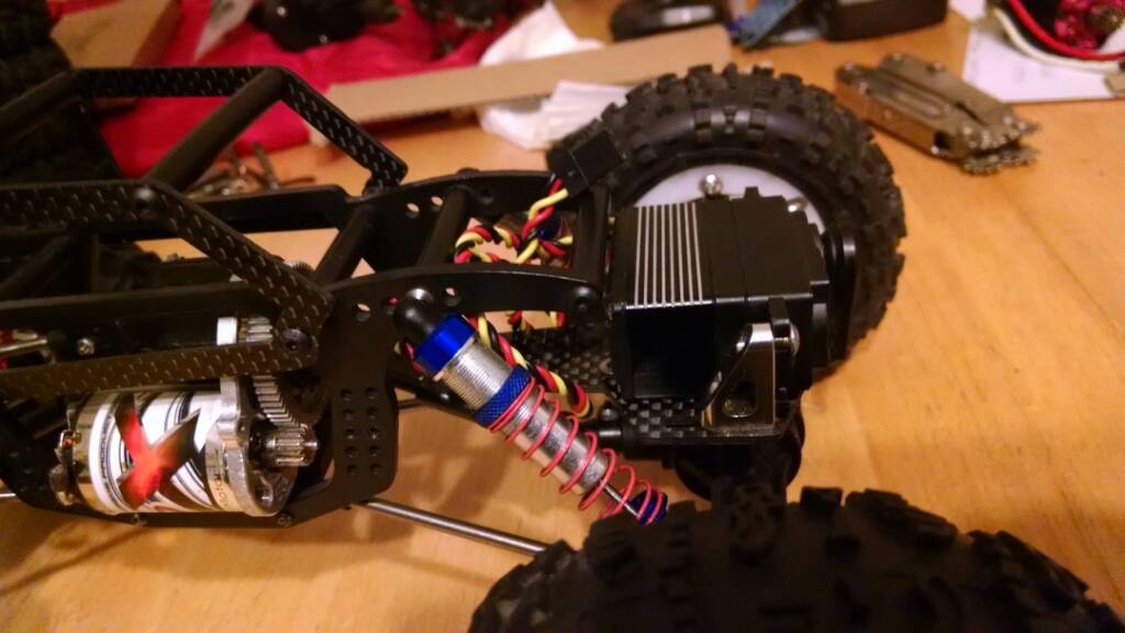

In with some CF.. This is a 4 link, from a friend of ours, Barrybelvadere of Barry's RC parts.
Now for a tie rod, drag link, slight bend to the rear uppers, gain a half inch in wheel base, shave tires, new foam setup, and reconfigure the electronics.. It will be good to go!

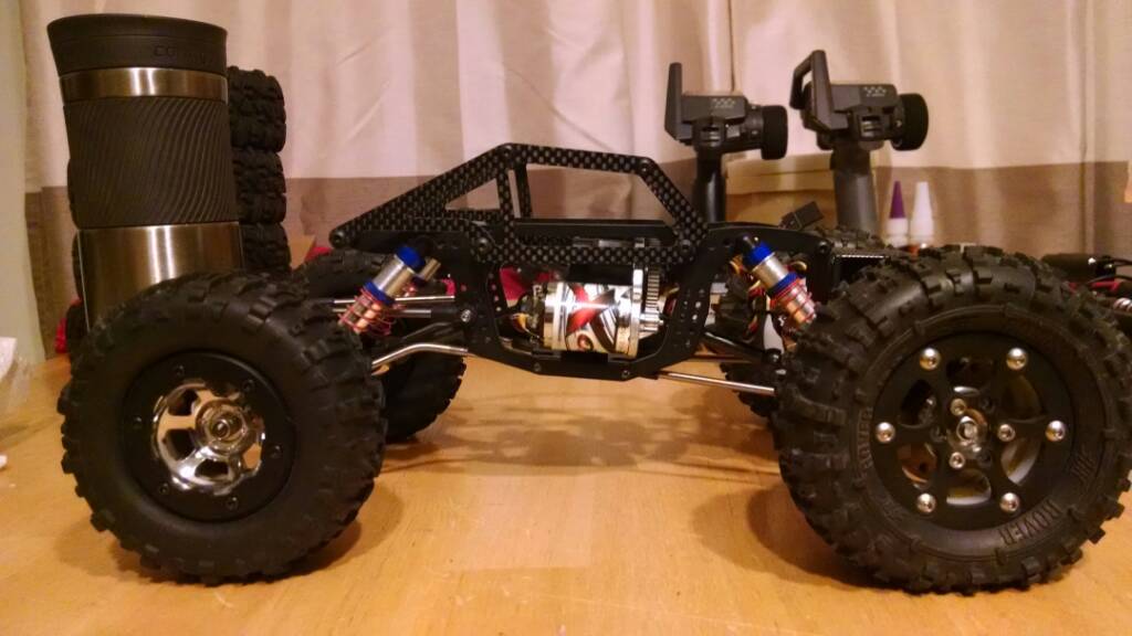

So I got the wheel base out to 8 3/8"
Looks pretty good now..
As this came to me, with a HH servo (which is long) and the front axle rolled forward, I swapped in a Hitec 7955.(for size)
Buuutttttt... It's still a little long for a proper setup, that I would build my own rig too..

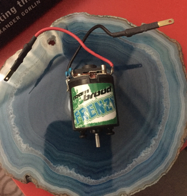

Found 2 of these while working on other projects this weekend. I was already looking into spare motors after my experience at worlds. If I'm going to comp out west, sand is going to get in there ( amongst other places). I'm glad to have these spares.

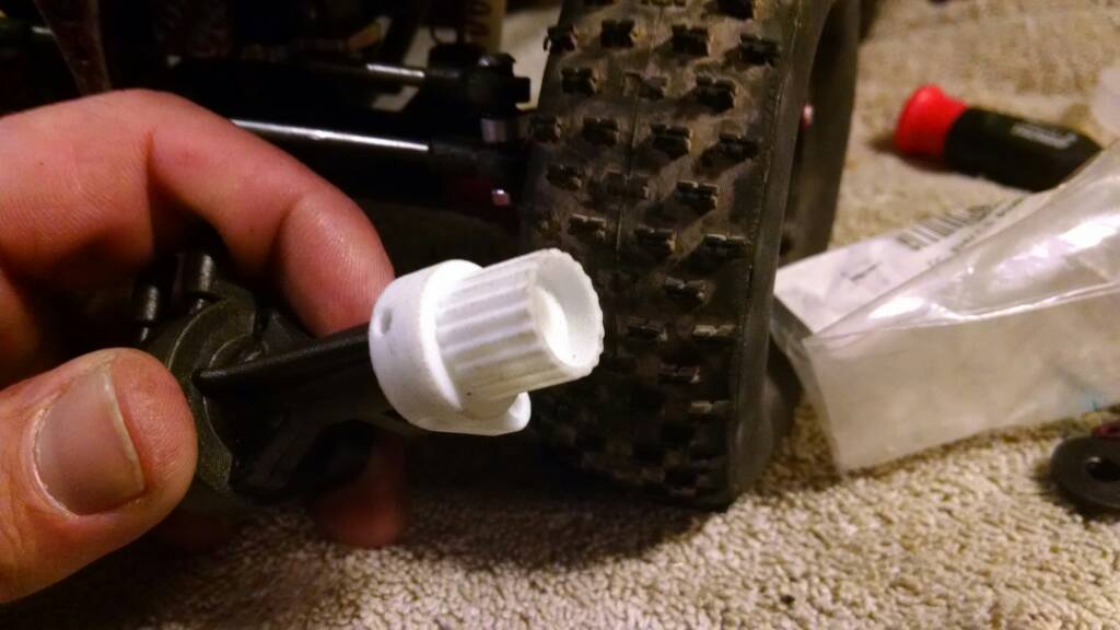

Shaved the "tower" off the back of a AHZ horn.
Which is a horn I would recommend anyone try!

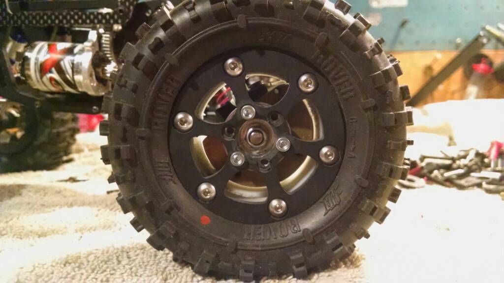

And got the back wheels/tires done and mounted..
I'm liking it!
