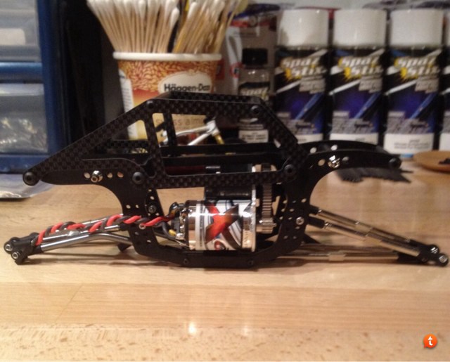

Next we have some details on the trans. Nothing crazy but a very cool motor I was sent to test out. An Extreme 380. Really looking forward to running this all season to really get a feel for it. The trans has 14/62 gearing with an aluminum HR spur. Some fresh new bearings on the top shaft and we are good to go. A very special thanks to 89redranger for help in this department.
Also have some pics of the trans mounted and carbon cab plates installed. That will be it for the night. If anything, check the berg or sporty section. I've got a lot of work to do there as well:)

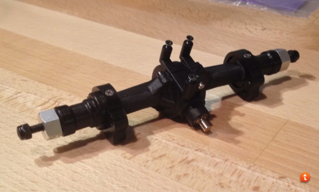

On to the rear axle. It's actually here so I should have posted about it before the front but here we go.
Ok, rear axle has stock mounts shaved with BWD link/shock installed. Shimmed ring and pinion using associated shims. Aluminum beef tubes compliments of 89redranger. They come in at 1/4"X .035" and 28mm long.
