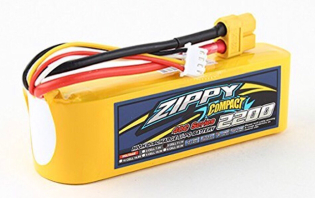

BATTERY
2x 2.200 3S batteries (distribute the weight more even)

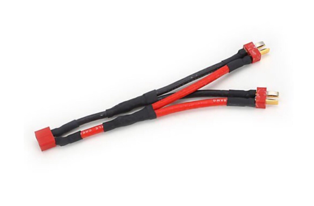

Cant find the Y harness to connect both batteries...

This is the Y harness to the batteries, right??
Yes that would allow for two batteries. Just so you know, that splitter is wired in parallel, which will double your run time, as opposed to doubling power. Also, you will probably need to change the plug on your ESC and battery to fit that. Last I remember the AE-5 comes with a Molex/Tamiya plug, and that's a Deans/Ultra plug.
As for batteries, I just use cheap Zippy lipos. That way, if it gets ruined it's a pretty minimal loss. Here is one that fits your description: http://www.hobbyking.com/hobbyking/store/uh_viewItem.asp?idProduct=58891
Just so you know, most people I know just run one pack in their rig at a time, to keep weight low. But you can do whatever you want.
Yes that would allow for two batteries. Just so you know, that splitter is wired in parallel, which will double your run time, as opposed to doubling power. Also, you will probably need to change the plug on your ESC to fit that. Last I remember the AE-5 comes with a Molex/Tamiya plug, and that's a Deans/Ultra plug.

2x 2.200 3S batteries (what brand?)
HARNESS "Y"
Castle Creations Parallel Wire Harness (just like the picture above)

Sorry I noticed your other comment after I posted mine, then edited it trying to answer that one too, not expecting you to be so quick.

The connectros arent the same??
The battery must be 40C its better??
This yellow conector is the same as the "Y" harness that im buying??
