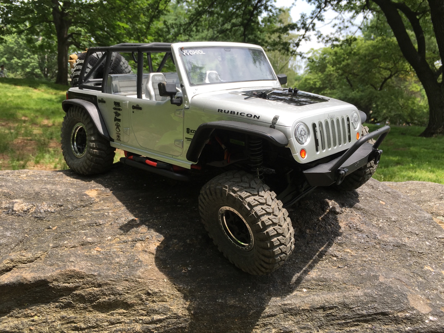

Building my exact Replica of my Jeep Wrangler
Playing and testing a little the new toy.
Had so much fun with it!!!
