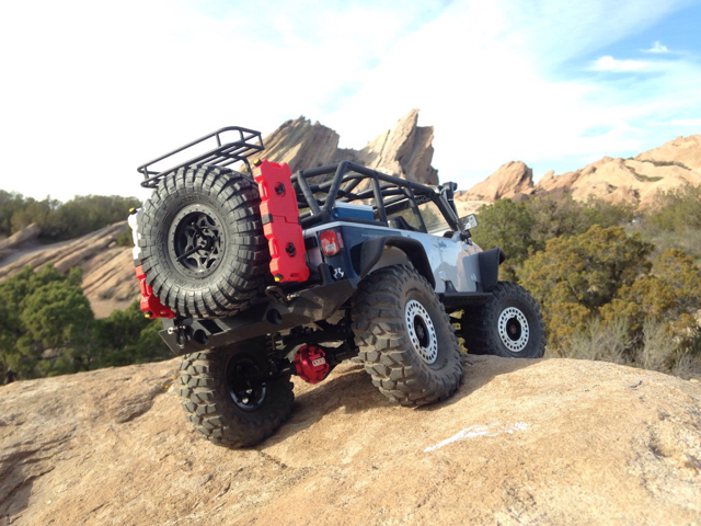

Rear rack can be used to fit RotopaX.
I can make the rotopaX available in blue so you don't have to paint the whole thing.

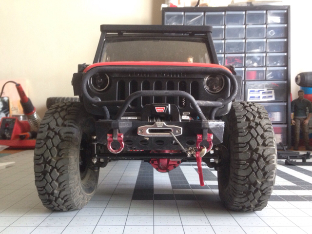

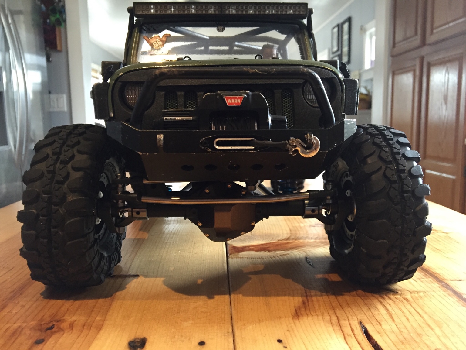

For the Axles I use the RC4WD K44 on one rig and the Vanquish Product Curries in my other. Both are awesome. The K44's have the optional Arb diff cover. I also had to use a 9mm off set hub on the K44's to get the width right.
Curries:
K44's
Curries:
K44's

The rotopax can it be just in one side, and without the rack? Just like in my jeep?
The K44's looks awesome!!! And knowing that they have the ARB dif cover, its perfect!!
Yes you can just cut the mount in half, you'll have to glue it or add an extra screw to hold it in place.
