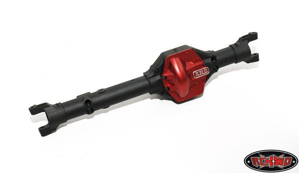

Found some ARB red Covers for the Diff covers!!!
Just to look like mine!!
ARB Diff Cover for Axial Wraith (Wraith, Ridgecrest)

Those are for the Wraith AR60 Axles, won't fit the SCX10. You might want to wait for the new SCX10 II to hit the market, it's got a more scale axle and comes with a red cover that will look similar to your 1:1 Jeep.
