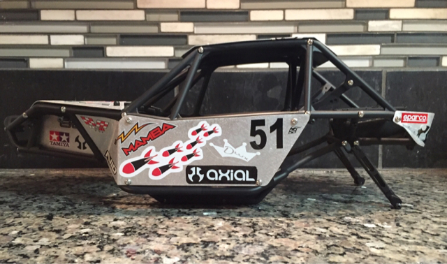

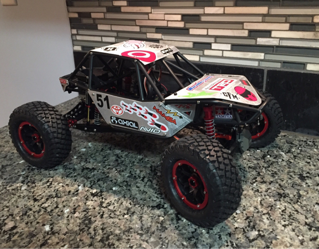

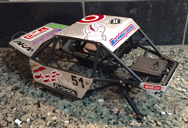

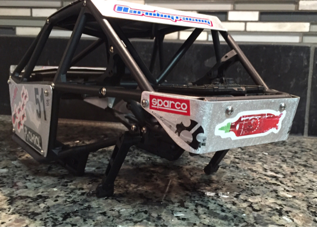

Bomber Aluminum Panels from Barndog Racing

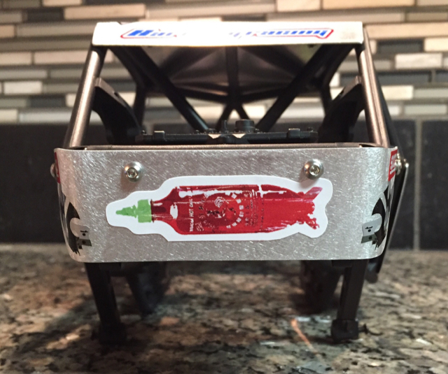

Rear panel in the HOUSE!! Sriracha Bomb sticker.... And easy install.
Great job Brandon!!
I just wanted to say thanks to barndog racing for donating prizes to the team MRB Fire and Ice event I gave away several sets of these panels they are sweet!

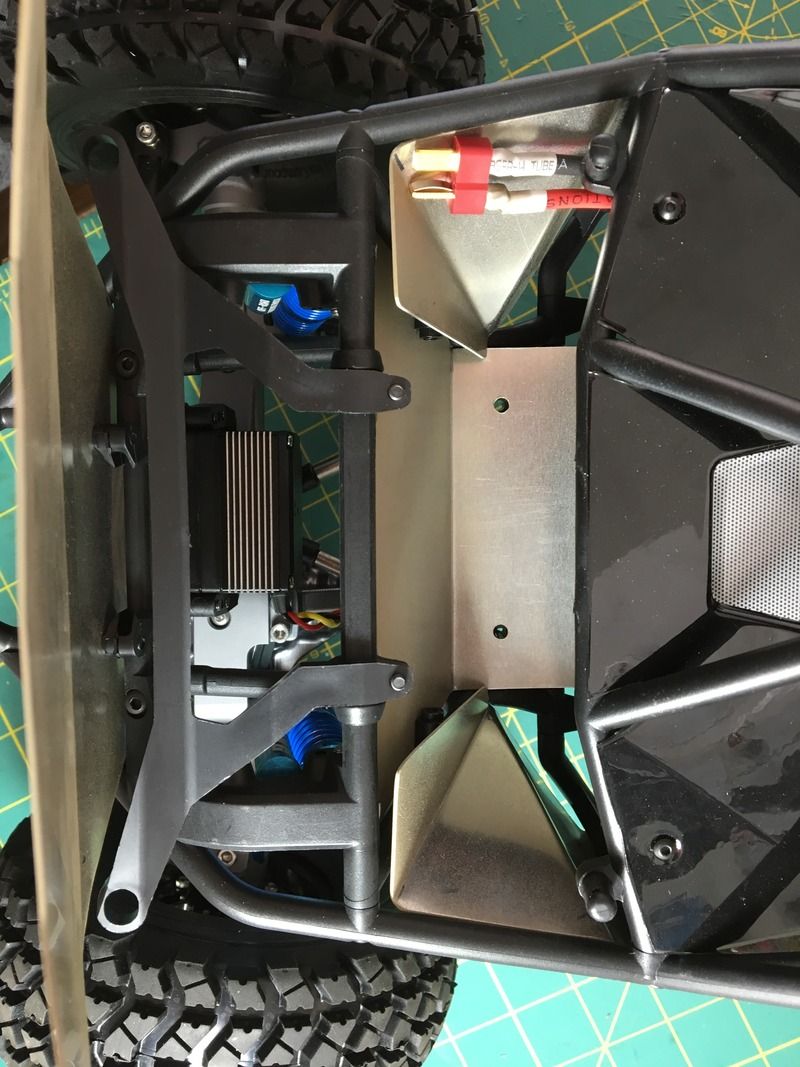

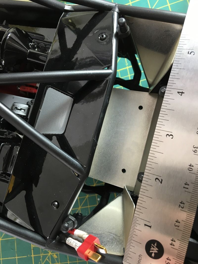

Battery firewall with full sides interior pictures:
As you can see it shortens the battery box a little which will affect battery length, but the depth and width of the battery box is larger than you can adjust the plastic axial battery box to.
The barndog battery firewall with the full sides (that delete the plastic battery box) allows for a 3.75" long X 1.5" thick battery max.
The axial plastic box allows for a 4.75" long X 1.25" thick battery max.
Hope this helps.
