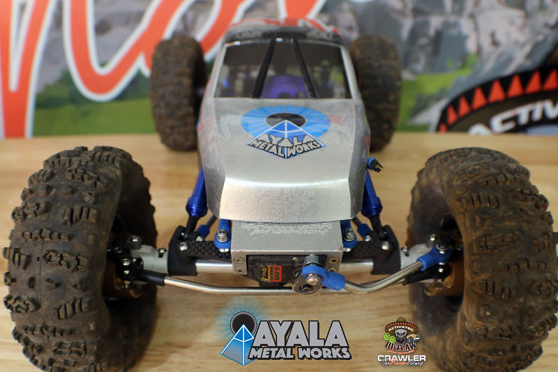

The only thing that I'm not so convinced is the servo placement...
Just don't like it, I think the servo arm is too exposed to the rocks and the small R/P pumpking makes it look even worst.

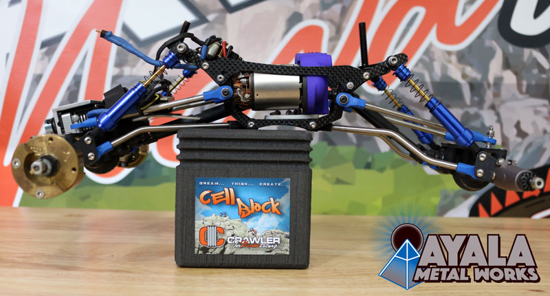

New bling :mrgreen:
Blue Dlux Shocks
I used my gold (titanium nitride) coated shock rods from the previous big bore shocks that have RPM Green 2 stage pistons in stead of the silver :mrgreen:.

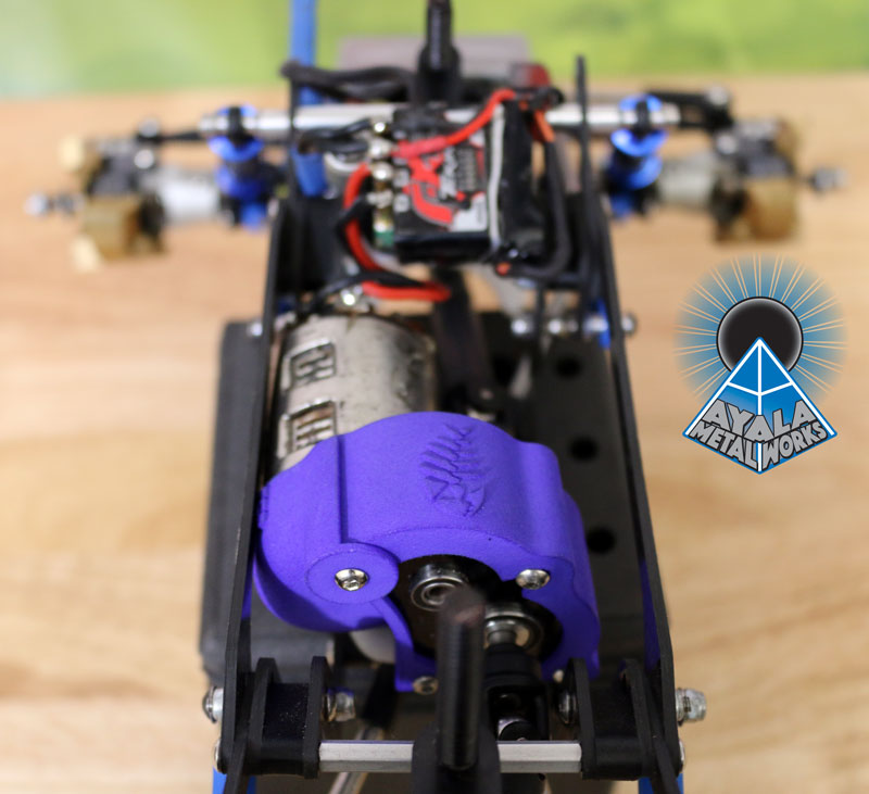

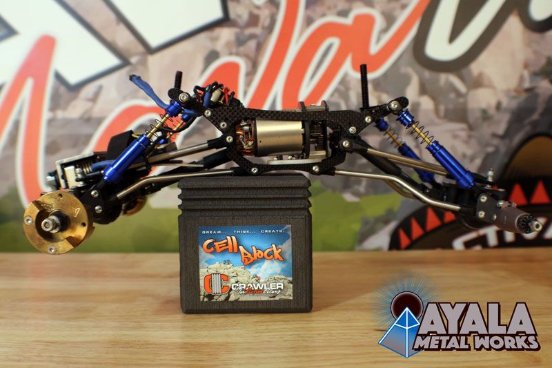

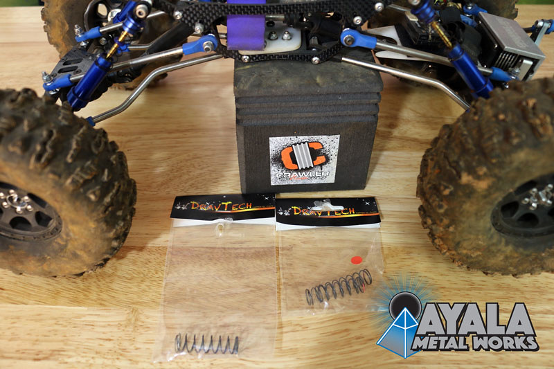

Fish with Fish's Crawler Parts sent me a Hamberger cover for Blue Iris. Thank You
I changed the black rod ends to RPM blue rod ends.
Hamberger Cover Weighs 8 Grams

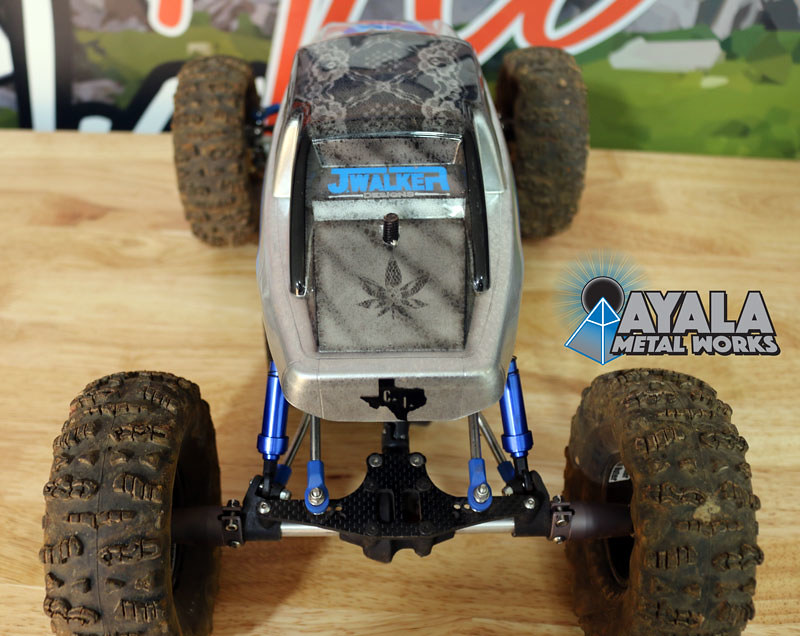

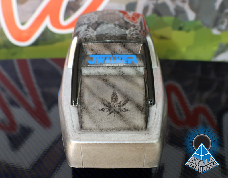

Update

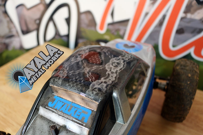

Blue Iris's X-Citer Comp Crawler Body painted by JWalker Designs that is spectacular Thank You Jesse!

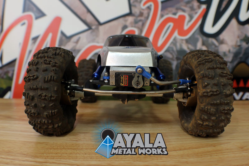

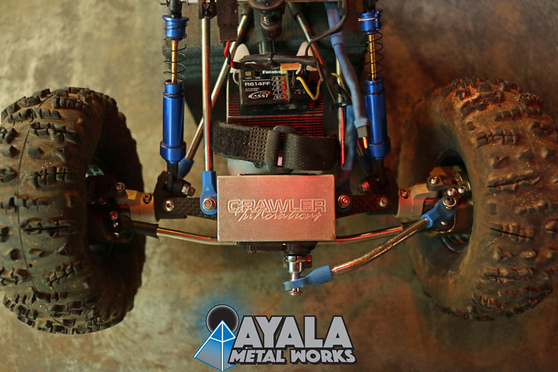

I switched the servo horn up and made a new steering link. This steering setup is way better and doesn't hit the rocks nearly as much.

I like the bent link as it allows for better approach angle but the bend decreases the servo power. I decided to try another steering link but with less bend.

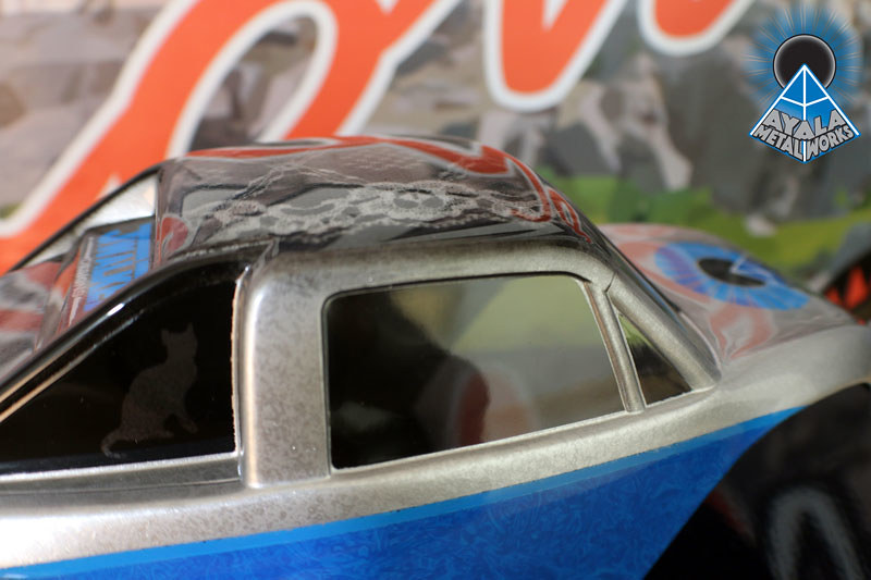

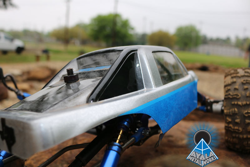

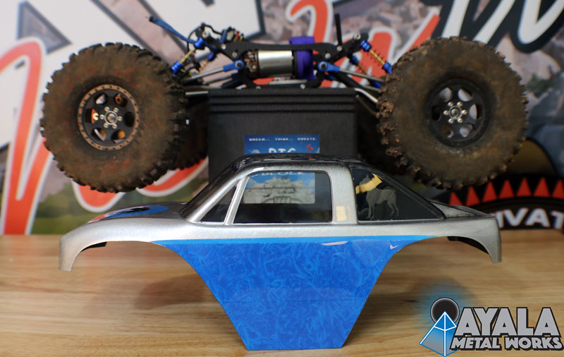

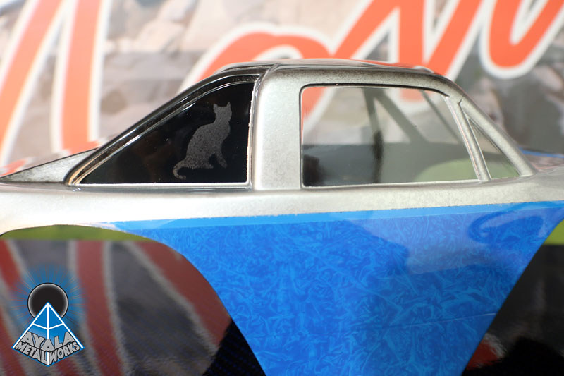

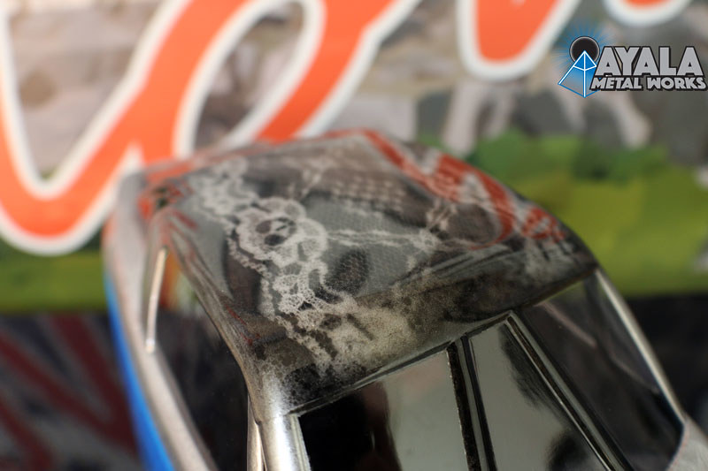

Edmundu and I crease the body and this passenger side was our first attempt. We used a heat gun and two aluminum plates. First we heated up the side and then put the aluminum plates on the side and clamped it and creased it to the desired bend. This worked ok the passenger side was kinda ruff but the driver side came out better.

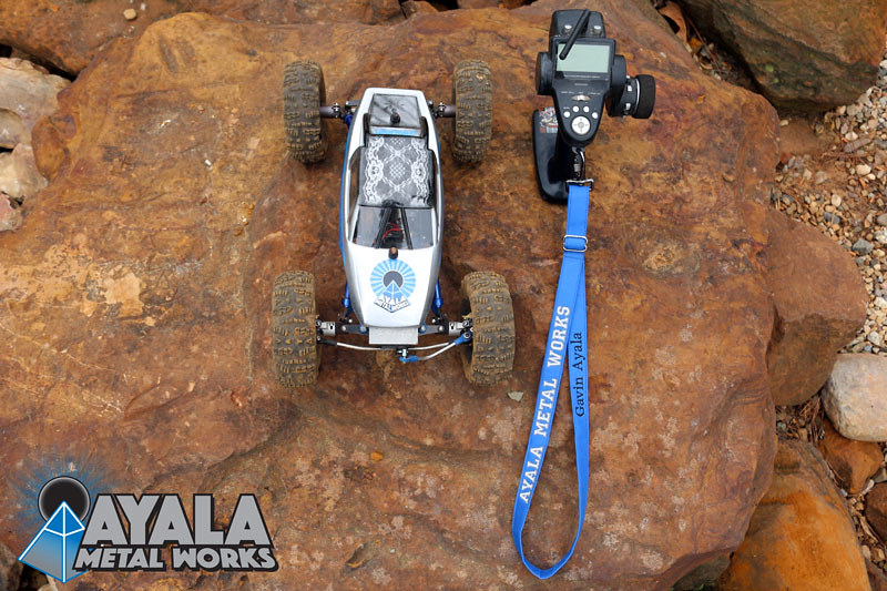

Photos from the Activated Outlaw Get Together on April 6
The Remote Strap was made and embroidered by my Mom. EmbroiderybyL

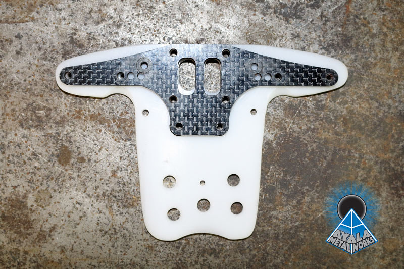

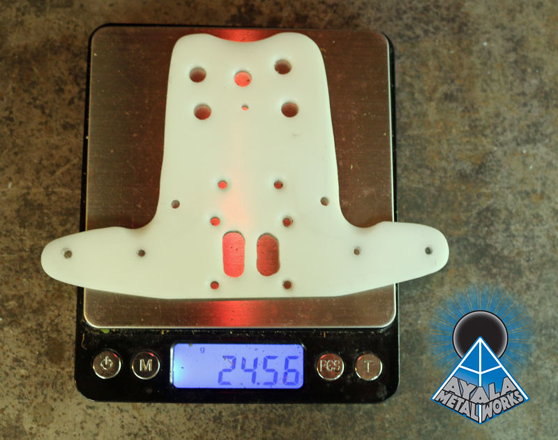

After the June 1 2019 Activated Outlaw Get Together I was very tired of the steering setup. The servo looses so much torque with the bent steering link. I decided to make a new truss to put the servo where I want.
Before
Weight of truss and battery mount 17 grams.
New 1/8 delrin truss I made.
Weight 25 grams.
I used the outside upper link hole and moved the servo holes back about a half inch(I forgot the exact measurement).
