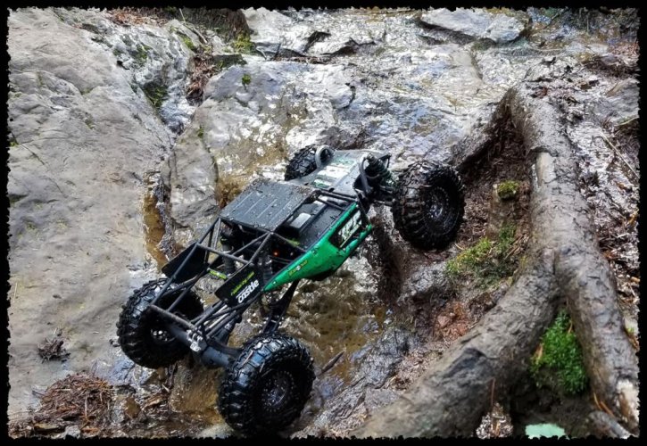

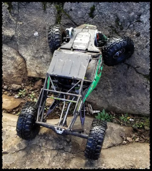

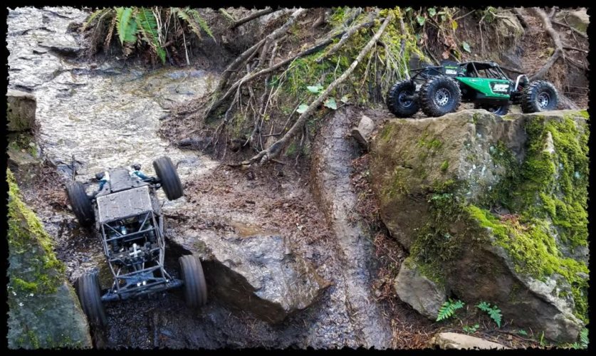

I was able to get out this past weekend with a couple of buds for a good "hammering"! The owner of the second TH and I are VERY competitive with our Hammers and the lines that we accomplished were spectacular. By far one of my favourite rigs in my collection of crawlers. At one point I thought my day was done with the front wheels pointing in opposite directions but luckily it was just a lost nyloc and I was back up and running in no time.....crisis averted! I swapped out the Castle 1410 green can 3800Kv motor with a Slate 2850Kv power-plant and was very happy with the performance, especially the low end resolution.
