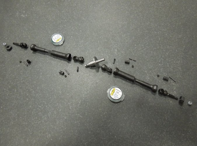

I'm wondering if this is what you are working with? MIP CVD Kit
Looks like all we would need is the output shafts to fit the drive cups? This looks like it would be a strong solution.
It was almost a month ago I emailed Matt and asked him about this 6mm locker and I'm still waiting for a reply. Be aware, you will either need to machine the ring gear yourself to fit over the spool or have him do it because it will not clear the output shafts on the spool.
Bil, is there something you aren't liking in the DLux design? It's going to be cheaper, much simpler, much lighter, and be more than strong enough while retaining the rear hub carriers. The MIP route may be a bit stronger but it needs more work to make fit. DLux's shafts are drop in solutions. 11 parts per side that can fail or 3? ;-)
