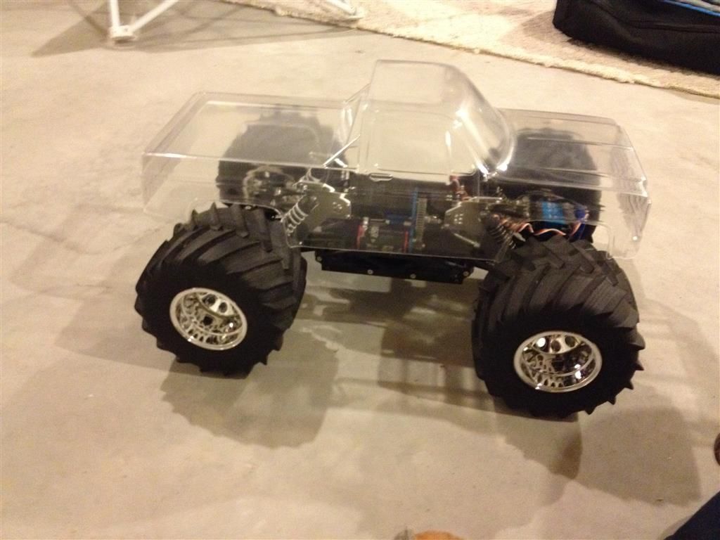

So while that was updating, I pulled apart the shocks, cleaned and re-built them with some new soft parts, mounted the front steering servo to start getting ready for the linkage, and just had to put some tires on it....
Some of tonight's progress.
Can't decide, Ford or Chevy....
And YES, the stock unmodified universals will turn this much.
These are TXT wheels with no hubs or anything. Mounted right to the hexes..
Just to see how much steering this truck might have. With no wideners, this isn't too bad...
I'm a ford guy but that chev body looks like a million bucks sitting on there"thumbsup"

Did a little more work tonight, while some paint was drying.
Was hoping to have this done for the monster truck race this weekend, but just not enough hours in the day.
But you know what they say, good things come to those that wait.

Between painting and decaling a body, and getting this done, I was VERY happy. But I couldn't leave it here.
Been dying to get it on some wheels. My clod wheels need to spend some time in the mill, so for now these will do..
Front Axle
And for those critics that say these are Sedonas and they aren't as big as a monster truck tire, take a second look. Yes, that is a RC4WD Rumble.
Since the Chevy body has to go on another truck, I kept trying to go with the Superduty monster truck body I have. Just not sure it is going to work.
Any suggestions on a body? Wheel base is right about 13.25".
Only body I won't put on it is a Grave Digger body..
