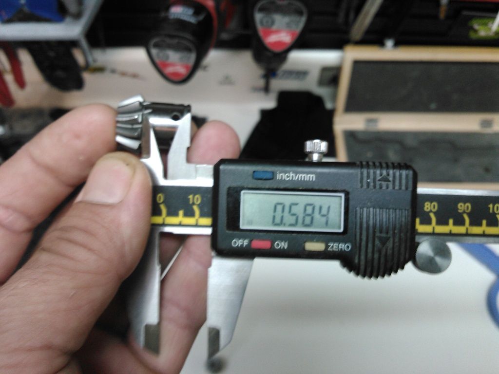

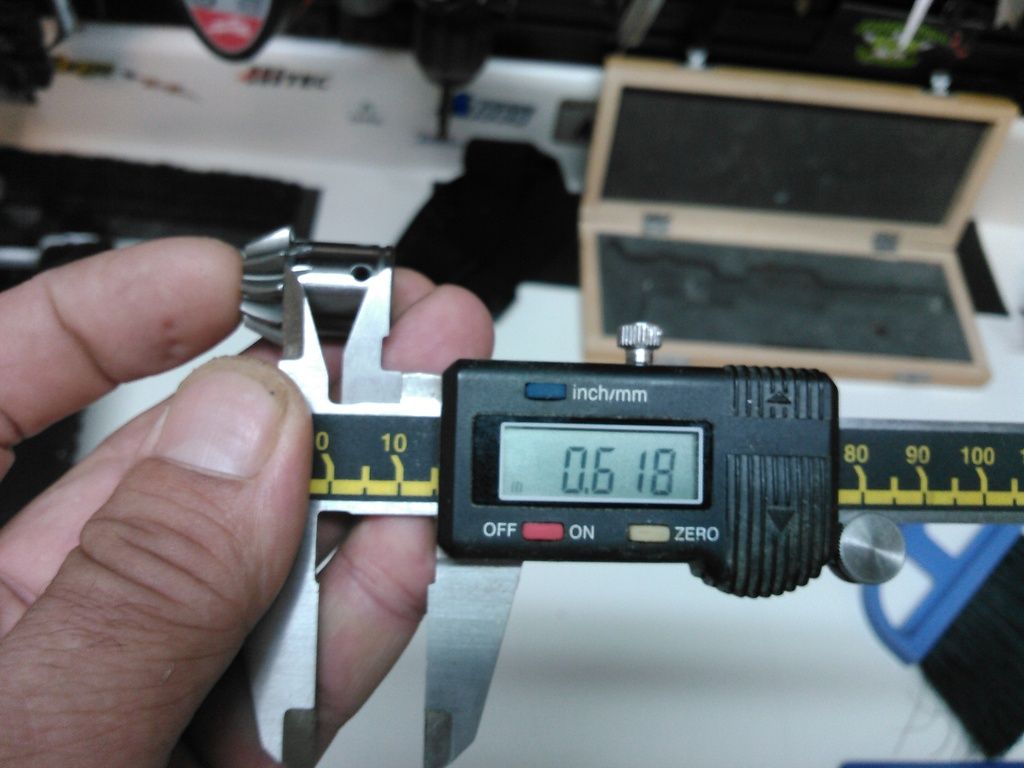

You know my opinion about this problem, it not a pinion/ring issue, but mainly a bearing issue being THAT undersized. Here are the original straight cut pinion after 100+ runs. As you can see, they look more than reasonable after all this time, both on 4S and 6S. The only two chipped teeth are like this exactly because bearings failure. Otherwise I would have absolutely no reason to change them
Remembering that stupid amount of shims needed to do the third bearing mod, it strikes me that Axial might have partially resolved this problem by making that edge at the end of the pinion. That almost 1 extra mm might help, considering that the width difference between the spacer and the bearing is 0.9mm. Exactly the length difference between the old pinion and the new one.

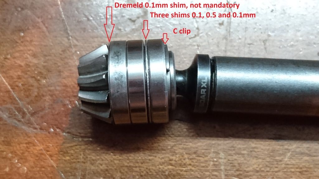

So, here is my mod
Shims in order from left (pinion side) to right (drive shaft side). You can use, of course, the standard 0.1mm shims provided by Axial, except you have to use more of them. In total I had to use 0.7mm worth of shims.
In addition to the original 0.1mm shims I also use a 0.5mm shim I bought some time ago. I also used an 0.1mm shim near the pinion which I had to dremel inside in order to have the inner ring of the bearing move freely. But this shim is not mandatory. However, if you use it, you do have to increase the inner diameter to more than 17.5-18.00mm. If you don't install this shim you will have a gap of about 0.1mm between the front bearing and the screw fixing it in place. Not a big deal, but that's me, perfectionist :)
I have to admit, not being very sure if this mod will work I even make a shaft just to be sure I can make BHB's mod. But after a few runs with my mod I'm pretty sure I don't need to cut down that edge.

Trust me, it does. It runs "butter smooth", I just came back from the track. I tried with 0.8mm shims and it was a little notchy. Not very bad, just a little bit. So I went back to 0.7mm

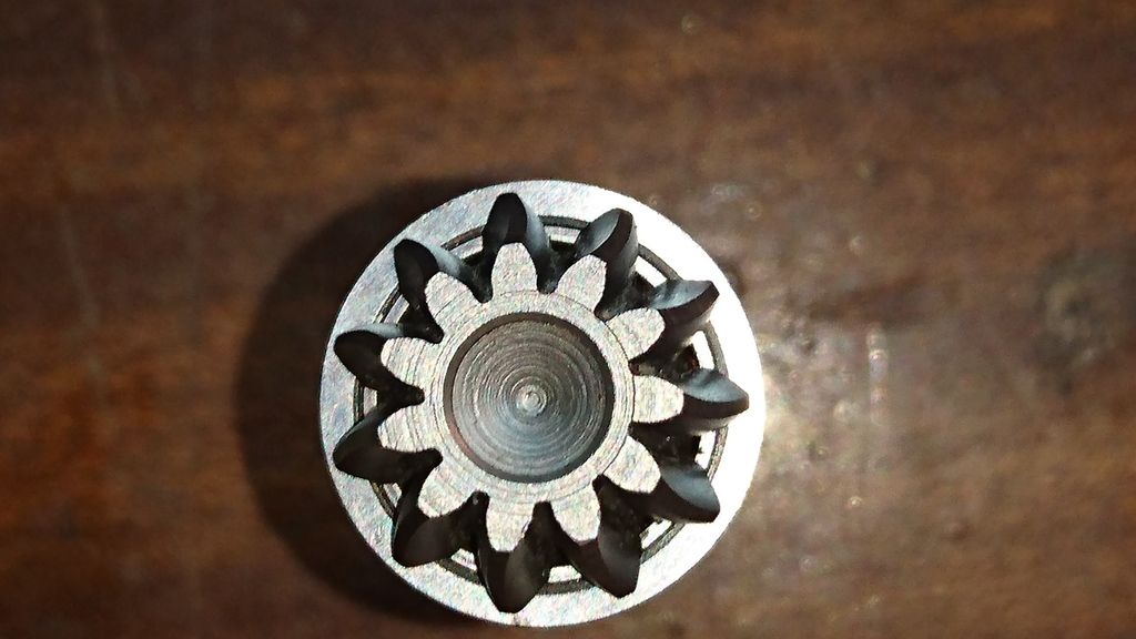

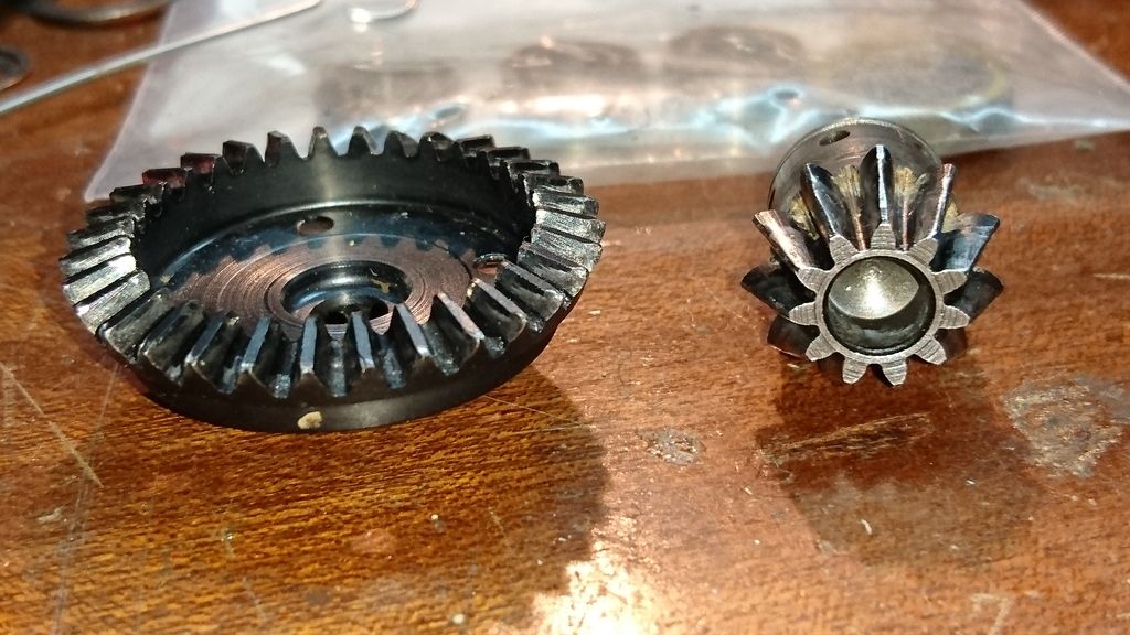

If you ask me this pinion/ring is another proof of poor engineering from Axial. Did you noticed how wide are the pinion's tooth at the end near the diff case? MUCH wider than the corresponding ring's groove. There is no chance to use the entire width of those grooves. This is why you have to pull the pinion away from the ring.
No the teeth prematurely mesh together because of the protrusion of the pinion.. It's obvious with a Vanquish.. The driveshaft wont even turn!! That's why Jimmy/Dhawk came up with the V2 bulkhead... To recede the pinion ... It took some emails and convincing but I got him to listen... Hens ... V2 bulkhead... and extinction of the Vanquish..

Yes, the protrusions makes the pinion to stay way too close to the diff case in regular configuration bearing-spacer-bearing. But with the spacer being replaced with the third bearing and a few shims you'll get the same result

In theory you can install any of the shims wherever you want and I tried to install one of them exactly as you say. But in real life that first shim will be deformed by the c-clip because all that forces are applied only to about half of the circumference of the respective shim. So, unless you can find a very thick shim, I wouldn't recommend this. You can try this, not very beautiful, but it works http://www.rccrawler.com/forum/axia...bell-crank-should-i-choose-4.html#post5520674. Or you can try a 1/8 nitro air filter
Those are the shims I used. There is no problem narrowing them with a nail scissors, if you need

All you need is to pull back the pinion from the ring because the poor engineering of those teeth, they are way too wide compared to the ring's grooves. Maybe I'll take a picture to explain better, but unfortunately I won't be near my cars for the next two weeks :(

If you use a modified 18x21 shim it wouldn't matter if you install it near the c-clip. But if you use a regular 15x21, yes, you are right, the pinion will be pulled back further more. This was true if you used the standard bearing-spacer-bearing, which has a given length. But if you use three bearings and the right amount of shims this length is whichever you choose.
!!!! But don't forget, if you choose to use those wide shims near the c-clip, don't forget to dremel it's inside to a minimum of 17mm, otherwise it will block the rotation of the inner ring!!!!
!!!! But if you use it between the bearings you HAVE TO make that "sandwich" for the exactly the same reason!!!! You need that gap between the shim and the outer ring. The only reason I used it instead of regular Axial's shims was because it was much thicker.
