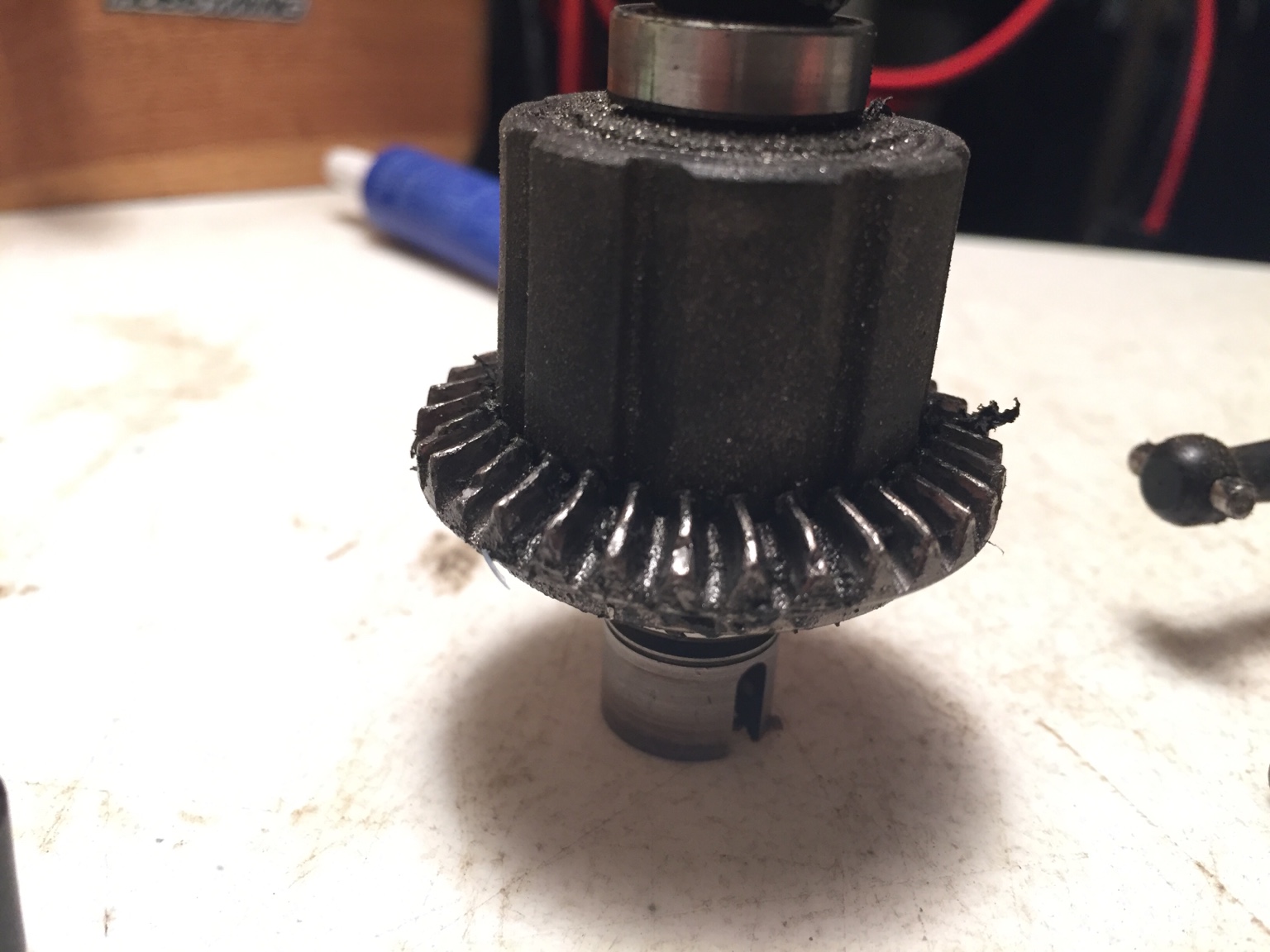

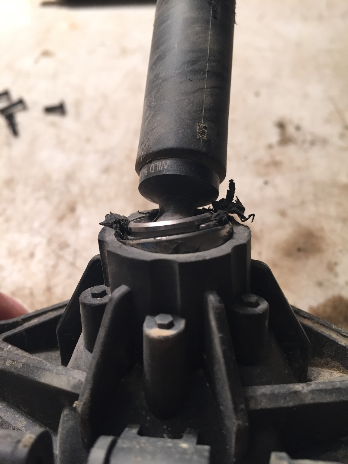

This is what happened to my stock housing with HD gears. [emoji853]

Ya man when I saw my pinion get pushed out with GOOD bearings .. I started to itch my head LOL"thumbsup I thought it was the soft plastic that others were talking about ... which is what lead me to buying the Vanquish ... Then it wouldn't even turn !!

Just tore apart the front end to inspect HD gears installed 5 runs ago, it looks like the pressure isn't being equally dispersed on the teeth. It turns relatively smoothly but only with the 4 diff case screws not fully tightened.

I think the consensus is that the plastic will work with spiral cut gears, because the spiral gears are less prone to deflect the force whereas the straight cut gears try and "push away" from each other under load.
I just dremeled my front gear, the one posted above, so will report how it holds up. The front is plastic housing.
That modification looks spot-on. And you're absolutely right about the deflection of forces caused by the straight cut gears. I would recommend aluminum housings for straight cut gears for 6 s capabilities and you can roll with plastic or aluminum with the HD gears because of the interlocking mesh... I honestly think that they would hold up to 8 s without an issue
