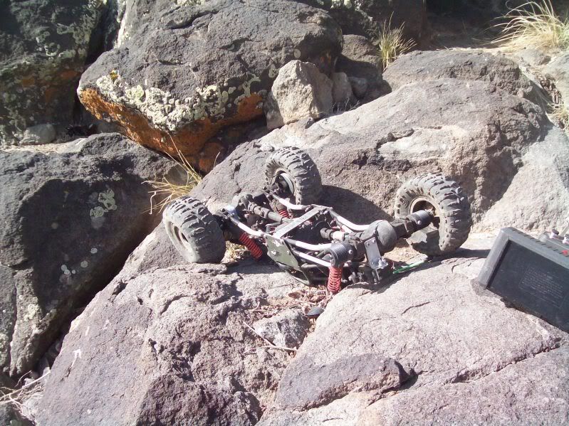

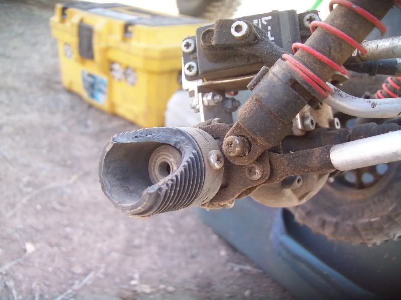

I managed to break one of my lockouts. It was made out of the end of the pvc that was threaded. My crawler took a fall off of a ledge and the tire rolled down the hill.:-( Will be making a new lockout, and some spares today.

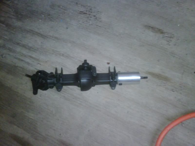

This is cool,so i tried it with aluminum round stock,I made mine a little diffrent,I extended the tube all the way to the end bearing,I machined an aluminum support ring for the end to take up the slack and make it tougher
I was affraid that whitout the support ring it may bend or wobble
Support ring installed
Thanks for the great idea. I built a set this week and they worked out great. $1.53 in materials and about an hour of labor. Saved a little coin and did it with no use of a lathe. Worked out Great......
