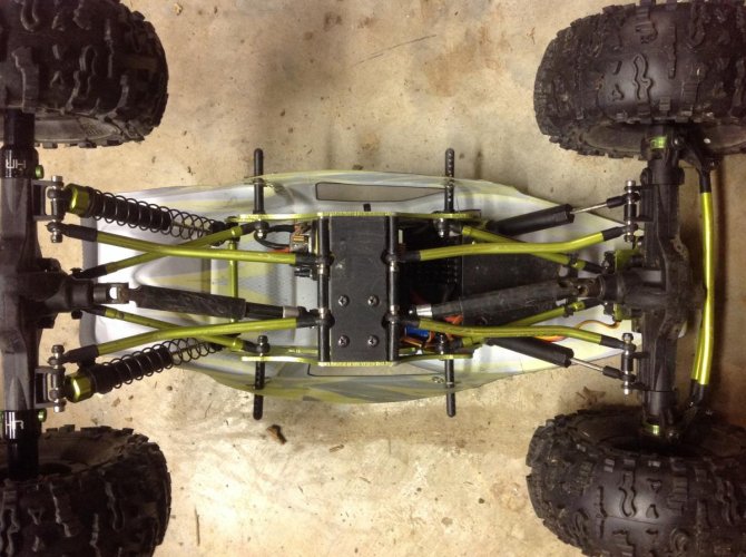

I have seen several posts about torque twist but not many solutions other than heavy springs which don't help flex or crawling performance. I have two Maxstones which are The same machines as the Everest. To me the worst thing about them was the torque twist in stock form. My solution is i boarding the links to fix geometry problems. One of mine is still on the stock frame the other is in a Gmade R1 chassis. The stocker uses the stock skid only cut down with delrin cross members to hold the links. The R1 is a home brew skid. I have virtually zero torque twist now on either one even running a 10t in the stocker and 13.5t 5 pole on 3s in the R1. Looks like I don't know how to attach both pics to this post so I will put one is a post by itself.

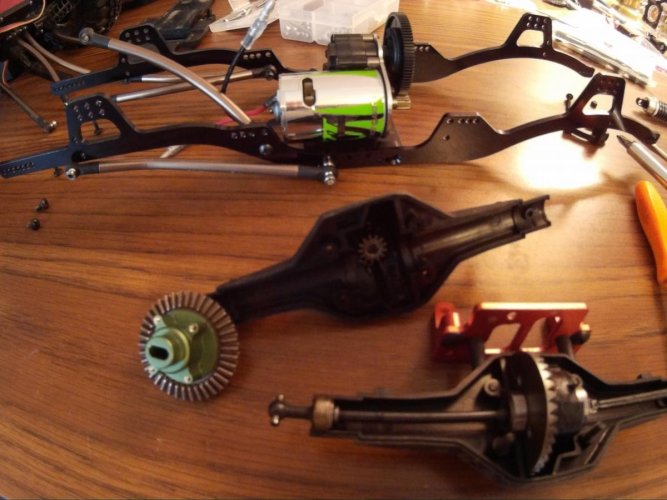

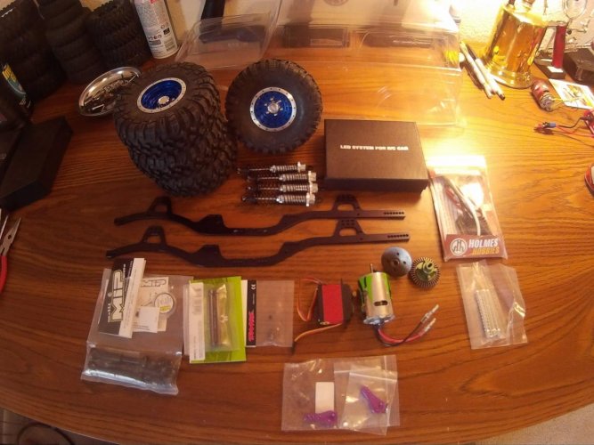

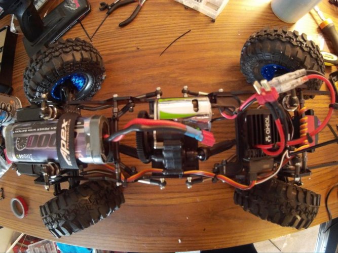

Just about got my E10 complete. Been collecting parts, and finally started on it yesterday. Fallowed Robotron's lead and used the X-Trail chassis.
Please forgive the quality of the photos. Used my sport cam and the wide angle lens makes everything goofy lookin.

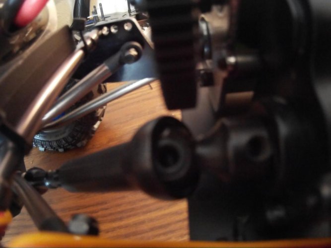

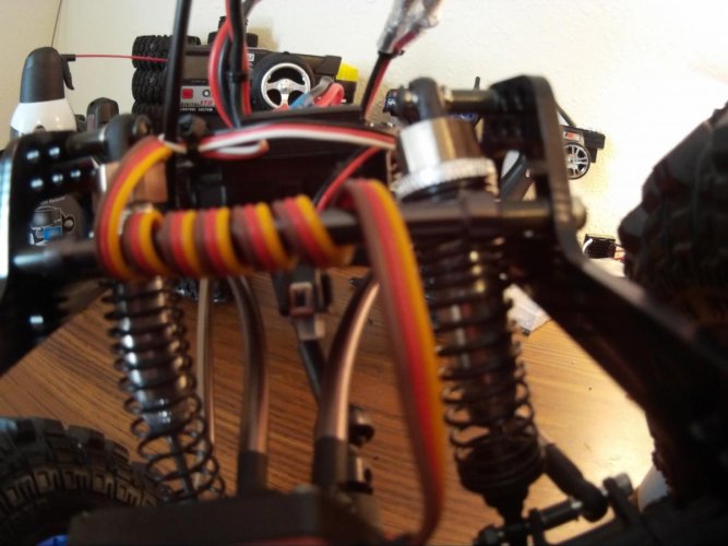

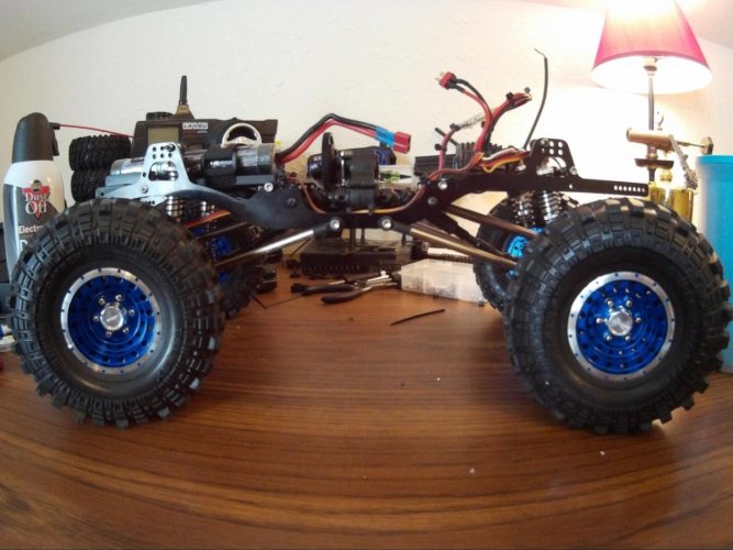

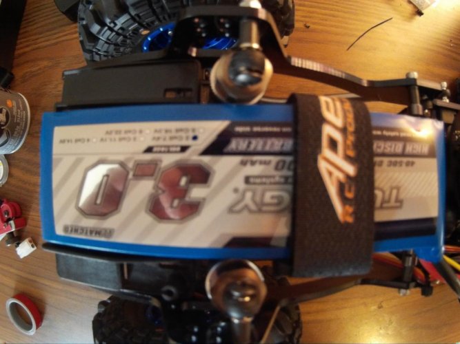

I got a pair of HSP lockers with gears for $16.00 so I figured I'd try them. They're a direct drop in unit. I mirrored the tranny and installed MIP cv's. The front one is super close to the spur, but it doesn't hit. I mounted the shocks inboard so the tires wouldn't hit them under full articulation, and they work. No torque twist! This thing is level, even in a hard crawl with the rear tires in a bind. Got lucky on that one! Shocks do run very close to battery and almost hit the chassis, but they don't :mrgreen: I cut about 1/4" from the upper links to improve the caster and pinion angle. Without doing this the caster is way off which causes the tires to lean really bad when steering. Wont steer worth a damn and looks stupid. Ground clearance is a bit high. 4" @ bottom of chassis with 100mm shocks, but I prefer lots of clearance, so this works for me.
I cut the radio plate from the battery tray, mounted the battery tray as far forward as I could and mounted the remains that I cut off directly behind the tranny. I bought a homes esc, but last minute I elected to install a Axial ae5. Going to see lots of water and mud and I cant bring myself to do that to a new esc lol. I am still in amazement at how well this thing crawls. The super swamper tires don't perform quite as well as I'd hoped, but they aint bad either. Plus I love the looks of them on the new wheels. Now to paint the Bronco body. I hate painting! :evil:
So, now that's it's done, I could have bought a Wraith for what I've got invested in a Redcat. I love the way this thing has transformed and I like the fact that it's mine and that it's my own creation, but dammit! I coulda had a Wraith!!!!!!!!!!!
