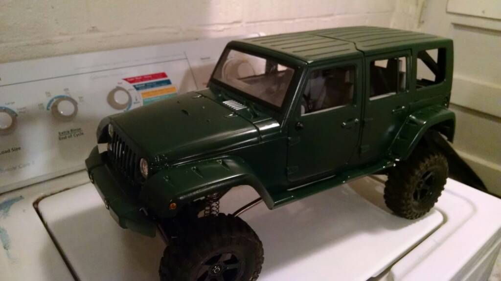

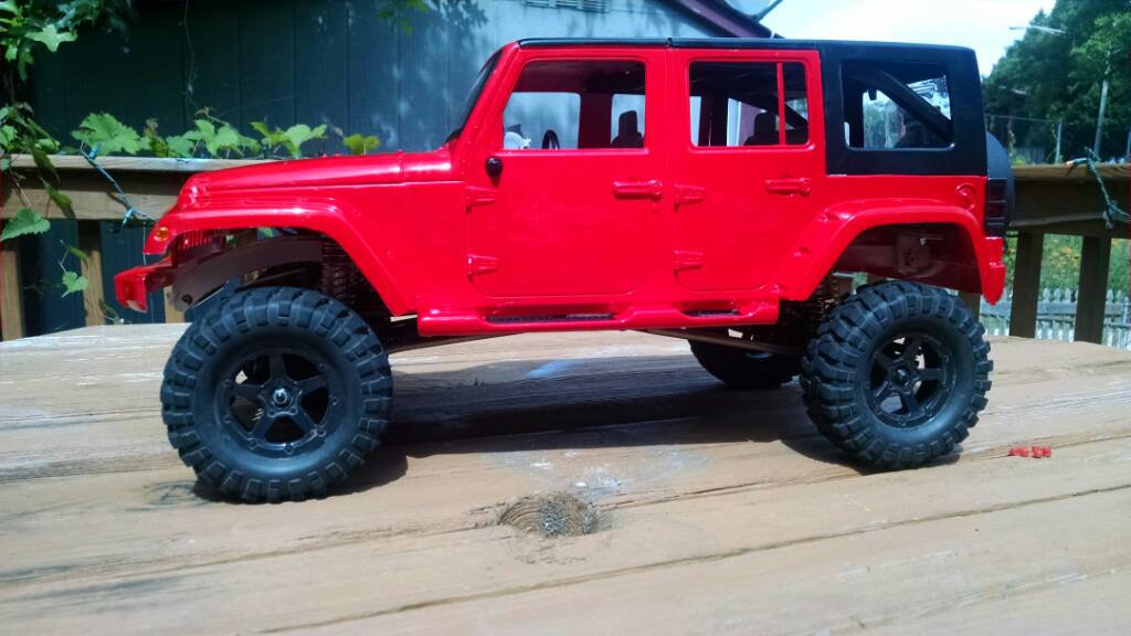

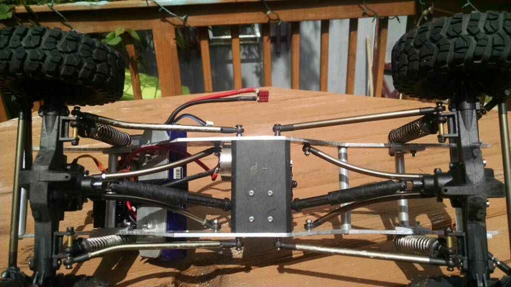

I finally got around to making body mounts and finishing the chassis. I have a new set of wheels and tires on the way too. Now on to the body.
I LOVE this chassis!!! Any chance you might be willing to upload the design picture with measurements? Please, please, please?!?
Thanks Stomper. I don't have any design files to share. I just took a piece of cardboard and used it to design the frame rails so everything would fit under the body/interior, then traced it onto the aluminum and cut with a band saw. It handles very well, but I need a more secure body mounting system as the Velcro doesn't keep it on tight enough.
Super-magnets? I know some guys use those to hold their Wraith bodies on, but it probably wouldn't work since the body has more substantial skeleton to hold on to. :(
