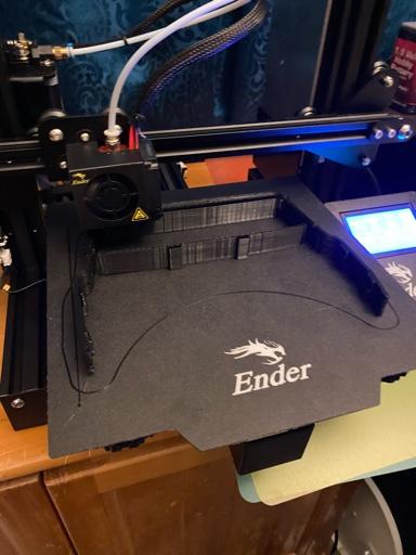

I was unable to see why slicer was having issues and I tried to do the next print from cura and was having the same issues. So I grabbed a small level to see if the printer itself was even level. The x axis way wayyyy off so I checked the base of the printer itself and got it level then the sides and top. Once I get the x axis level I adjusted the print bed using a piece of paper and got it to where there was some resistance from the paper, but it would still slide over it.
With the printer readjusted I tried doing the next print and again had the same issue! So I stopped the print and homed the printer only to realize the print bed was to low. So after adjusting the print bed again I retried the print and its working great!
