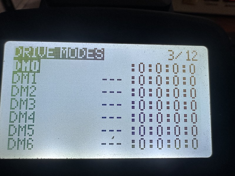

By default, switches T1, T2, T3, T4, & T5 are all trims. When using these switches as switches and not trims, the radio gives you audiable alerts as to where the trim is, which is a bit annoying when you are using these switches for winches and such. You can switch between "Trim mode" and "3-Position" mode, removing the annoying verbal indicator, and decoupling the desired switch from its trim duties... Of course, that has to be done for the specific model you are running.
MDL
Drive Modes (3/12)
• Edit DM0
• Trims
--> Initially the trims are set to '0', and there is one '0' for each of the the trim switches. Change these '0's to '3P' for the trim switches you want to be regular 3-position switches.
This is how it will look before changing anything:
Untitled by Scott O, on Flickr

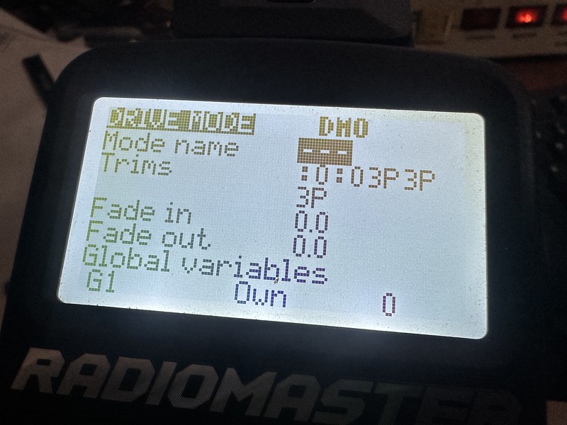

This is after trims T3, T4, and T5 have been changed to 3-position mode:
As discussed, this radio and its operating system are cantankerous at best. This is one of those many functions that allow you to do what you want with the radio, but have absolutely no intuitive process at all.
