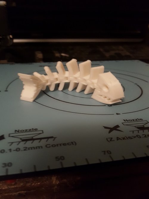

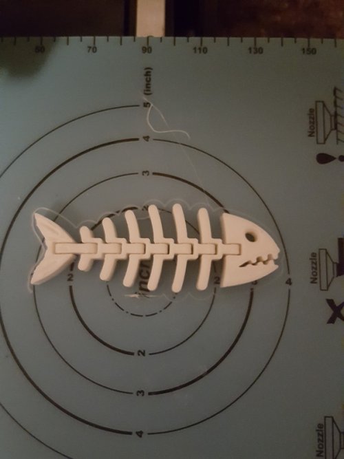

I leveled out the SooWay, and made my first test print, and like how it prints, the only problem is that I used the Cura software and tried to load another STL file on the SD card and it wiped it clean, all the system files are gone and my desktop will not detect the SD card, the printer says there is no files, now I got to e-mail them and see if I can get another loaded SD card or download the system files, there is not a lot on the website either, I really don't like or care for the SD card BS too be honest cause they suck and do exactly what it did, its not the first time I have had a SD card take a shit on me, my old Samsung Galaxy S3 went thru a few of them, the Ender 3 Pro you can re-download the SD card files and add a better card reader, looks like with the SooWay I'm going to have problems

I just printed the Flexicat version of this, turned out really well.
