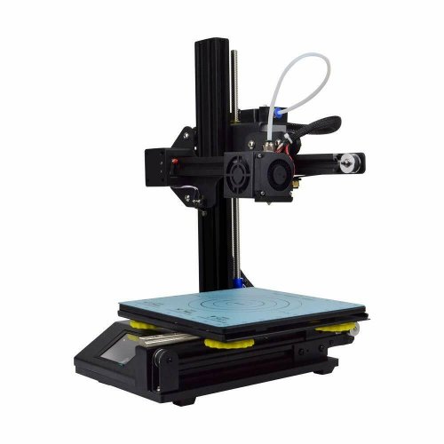

I think I have a addiction or I do things back wards, I was advised to buy a small 3d printer and get familiar with printing and the software and then step up to a bigger printer, when looking for a small printer, in my previous post I bought a new Ender 3 Pro, that's in shipping and tonight I found a Open Box SooWay SW 200T with a 180x180x180mm heated print bed, so that's 2 in 10 days, Hello my name is Bob, (not my real name) welcome Bob to 3D Printer Anonyms, anybody want to sponsor me
My name is Scott, and yes, that is my for-reals name, and its my thread, soooo I have first dibs on any sponsorship. "thumbsup"
By sponsor I meant someone to of knock the credit card out my hand and remind me, I had one printer in shipping, I really didn't need a second one, the Ender 3 Pro was a educated purchase, I watched Utube videos and read reviews and looked at upgrades and what other people have done, the SOOWAY SW-200 which looks like a clone of a Ender 2 was a total impulse buy, and there is not a lot info on it, it might not be that bad
