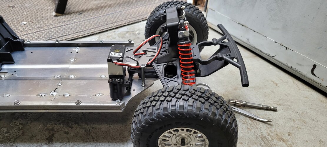

I am deleting the stock trans, and replacing it with the summit trans as you see it centered in front of the rear diff.
Additional, i am going to install a summit differential, however, transverse, right in front of the transmission. The diff will be missing the pinion and related bearings, but the rest of the internals will be present. This way i have servo switchable RWD,4WD or AWD 4WD in a sense depending on the weight of silicone oils I put in that diff

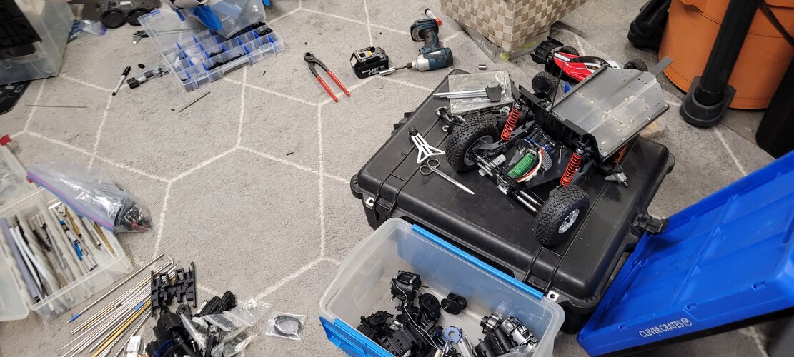

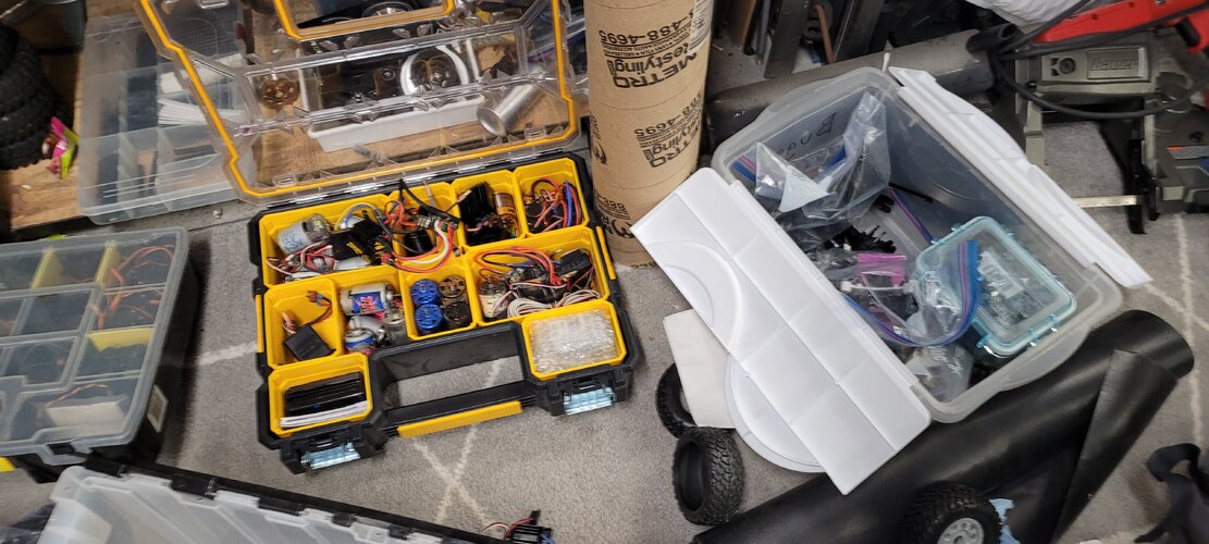

So, minimal update and a big mess in my garage 20241004_093930.jpgi have new stuff, old stuff, here, there. 20241004_093942.jpg everywhere! 20241004_103137.jpg

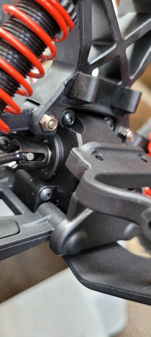

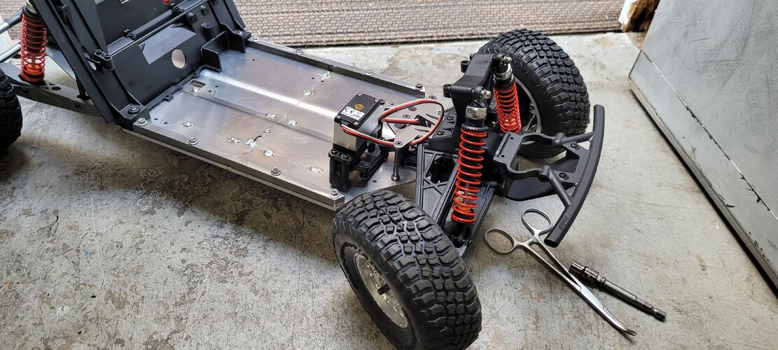

The front suspension bits and the rpm bumper for the baja rey 2.0 showed up. The arms fit with about 2-3mm shaved off. However, the rpm bumper connects to the shock tower on th BR differently 20241004_103128.jpg differently than on the RZR.
20241004_111537.jpgNow I need to figure that out. Maybe an alloy baja rey 2.0 shocktower. I really don't want to spend $20 for plastic parts!

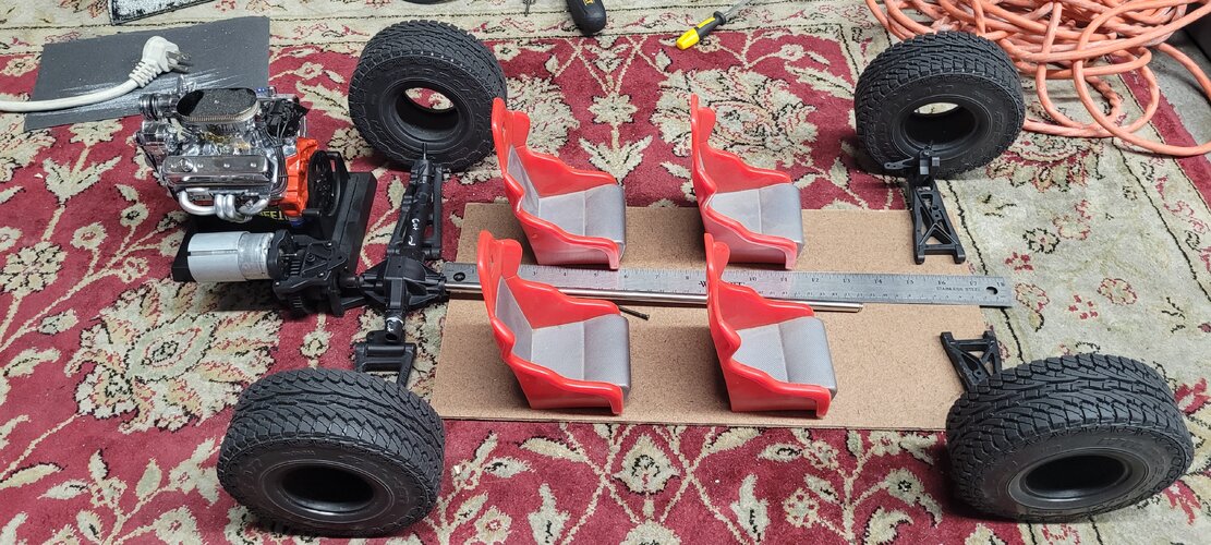

On a sidenote i scored a set of alloy shock towers for my rock rey, so I will try to put a hammer rey rear bulkhead on this, and the plastic stock towers from the rock rey. That will lower the "mock-up" height to a much better "look", which should help with cage werk.
Look at a Jimco class 1 / 1500 Hammerhead buggy. Same rear format, so once the bug is done, you now could do a go fast desert racer, like the Wilson rig.
Does that resemble something like this, but less hand size?
Then yes, that's what all the other parts are for.
