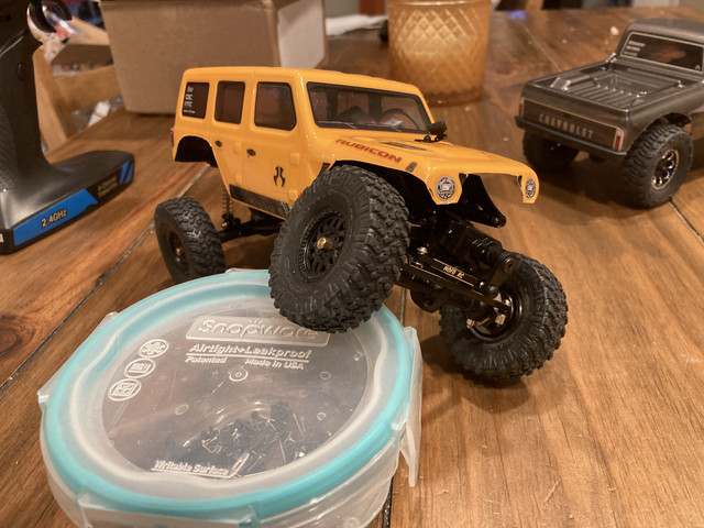

I just did a 4 link conversion up front on my Jeep and had to do some trimming to the grill area on the body to clear the servo with the new extended wheelbase. I relocated the front lower links to the top and used the extra rear lower links that come in the scx24 kit to use as the front lower links. Finished it off by trimming and installing the extra female drive shaft after cutting it to size.
I used the warthog chassis YouTube install video because he goes through the 4 link conversion as part of it. My goal is to get up this stair climb we’ve made in the house that as of now is not doable. We can get so close but just can make it up the last step! I’m looking for that little extra to make it happen and maybe this chassis extension will help.
Anyway I’m not 100% in on the changes I’ve made. I’m going to run my jeep this way for a bit to test things out. I’ve also got a bunch of parts coming in the mail like patigonias which I’m counting on to improve things as well.
I’d love to hear from you guys on your preferred setups? Why do you run your rig the way you do? Pics would be nice as well if possible.
Here is mine. It’s still a work in progress.
