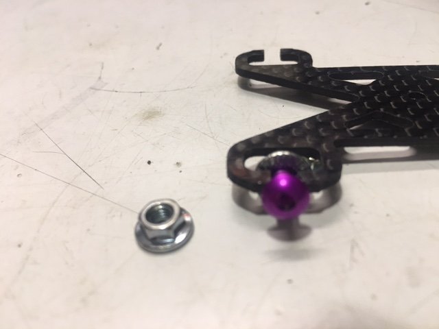

The chassis stiffeners would move a little. So I made small notches in the nuts. It seems to be holding the stiffeners now. Here is picture of the notch in the nut. Then I turned it to line up with the plate.
I had the same issue with stiffeners moving
Here is another optional fix get some Duratrax 3mm serrated flange nuts PN# DTXQ 0413 .
Makes life a lot easier plus more surface area to hold the CF chassis braces no more movement now
