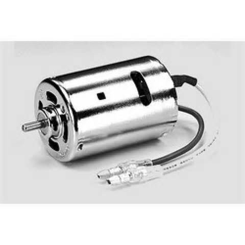

These are not designed to be taken apart.
