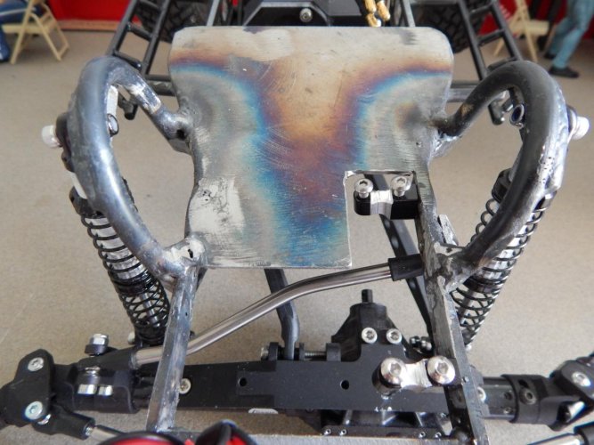

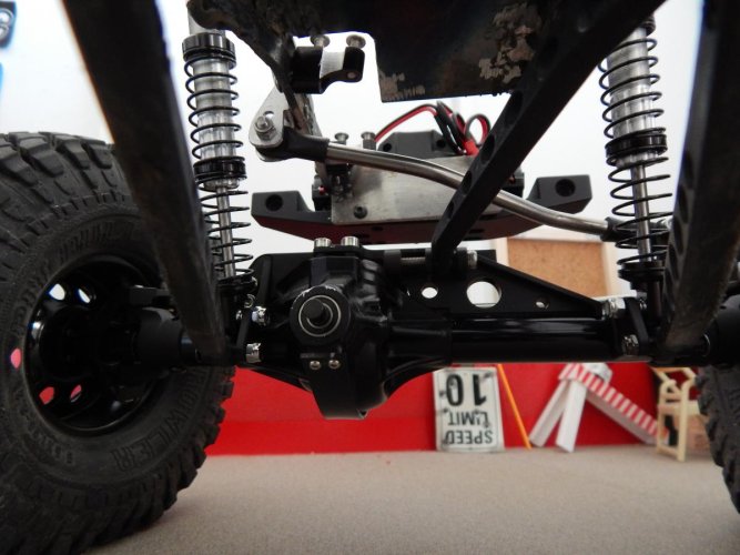

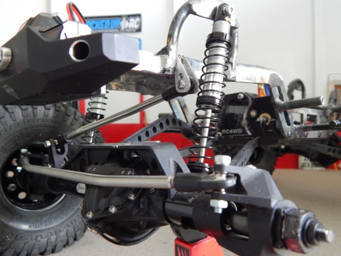

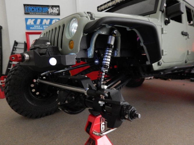

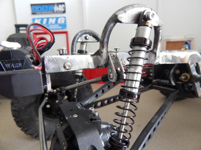

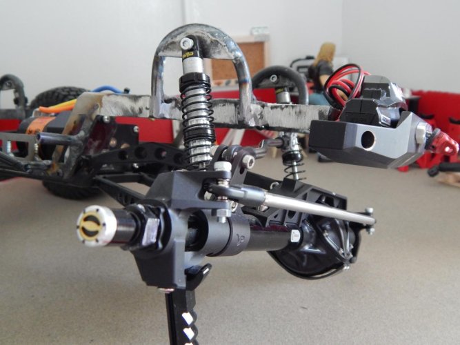

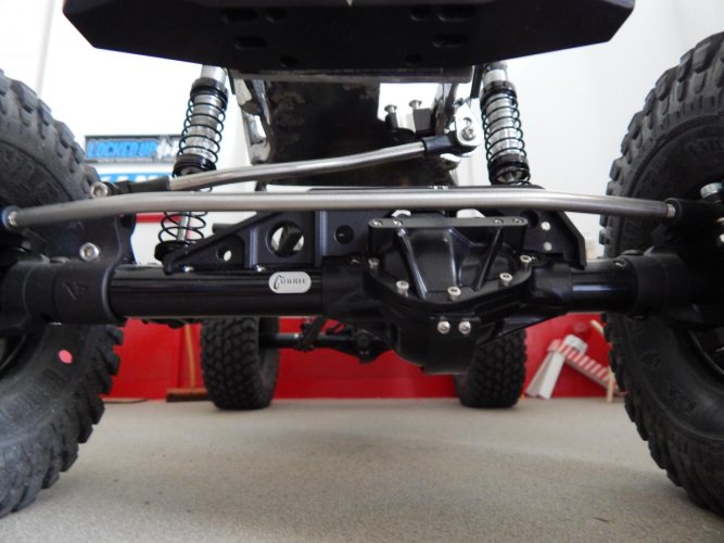

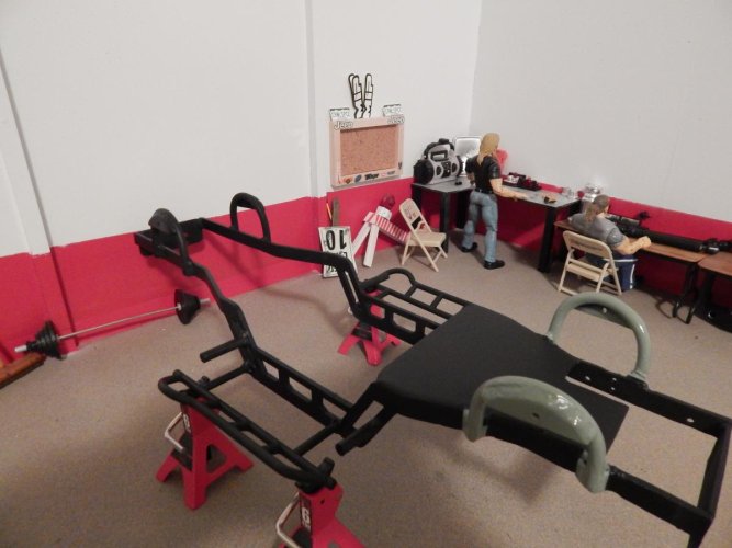

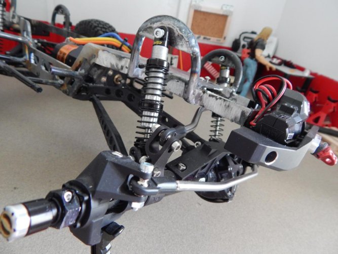

Here is what I got lined up for the pan-hard set up. No binding and hopefully no bump steer still need to make a steering link once I get the servo I want.

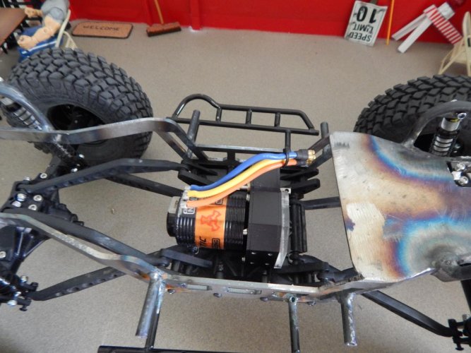

Some more of how the CMS is set up and the three link. The CMS is going to be just a standard sized servo. I think I'm going to go with a Savox SA-1231SG. I still need to get links made to replace the stock plastic Wraith links. I'll have the front links shortened a little bit as well.

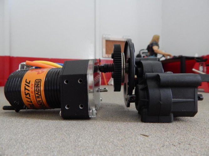

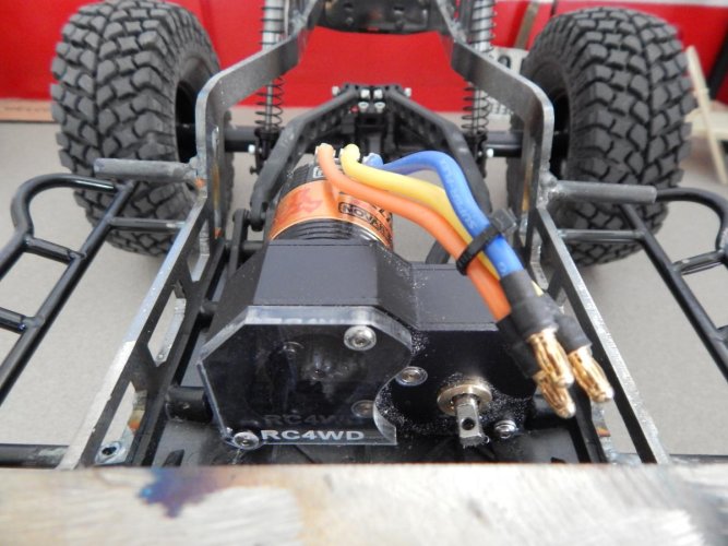

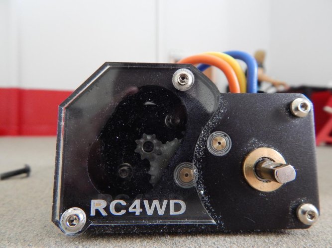

I also had to change the transmission on this build. The stock Wraith tranny was too tall to fit under the interior of the Jeep. I went with the RC4WD, R2 Black Crawler Transmission V2.

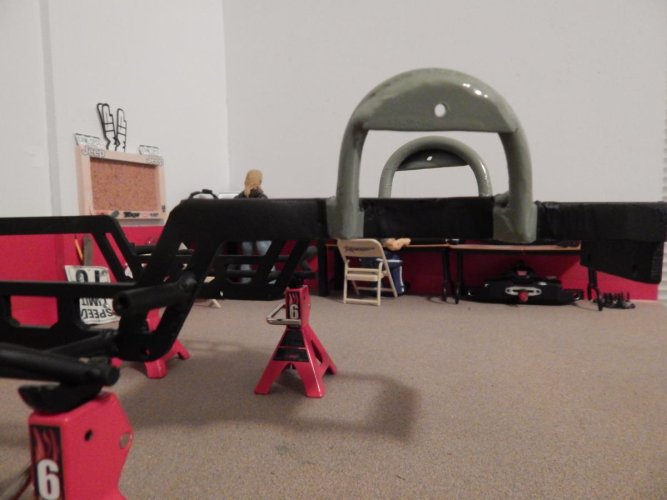

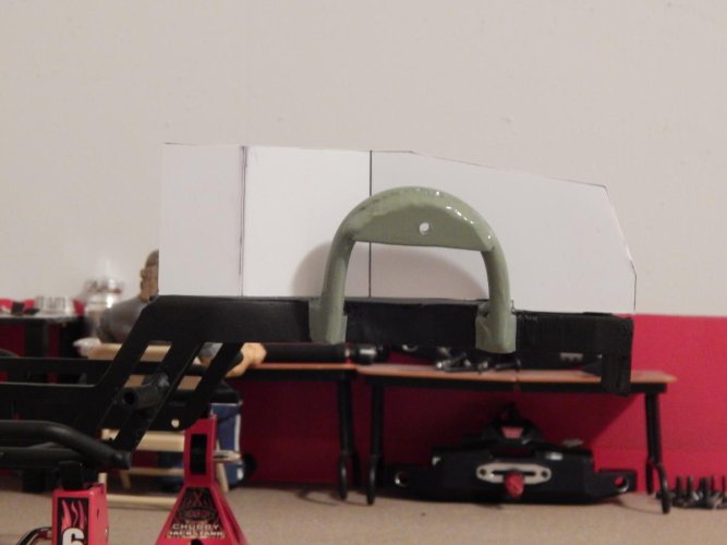

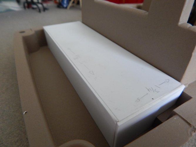

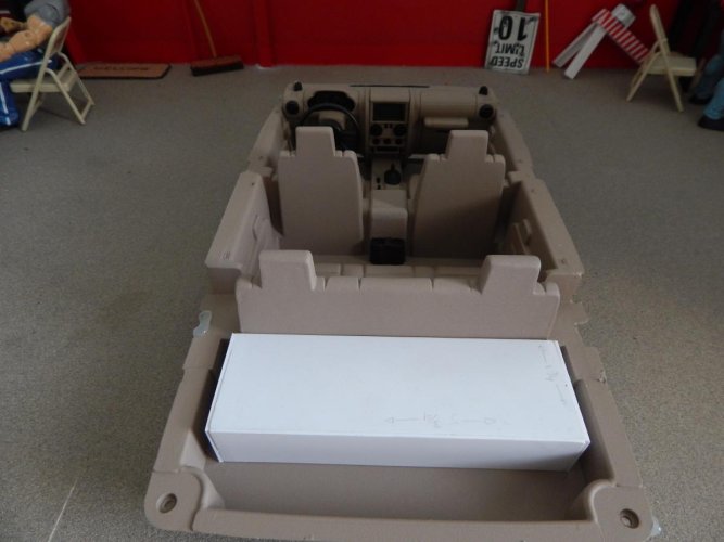

worked on filling the big hole in the trunk area of the interior. Got a big box but I don't know what to make it into. Maybe put some faux drawers or something???? Help me out! what should I make the box into??

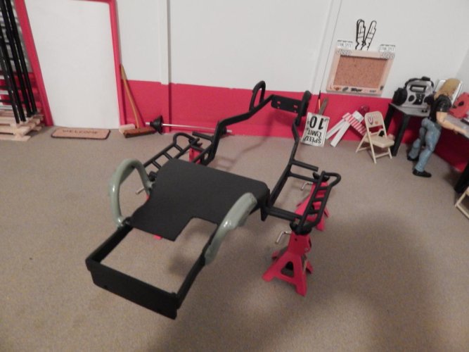

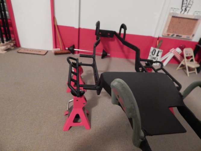

Finally got to throw some paint down on the frame yesterday.

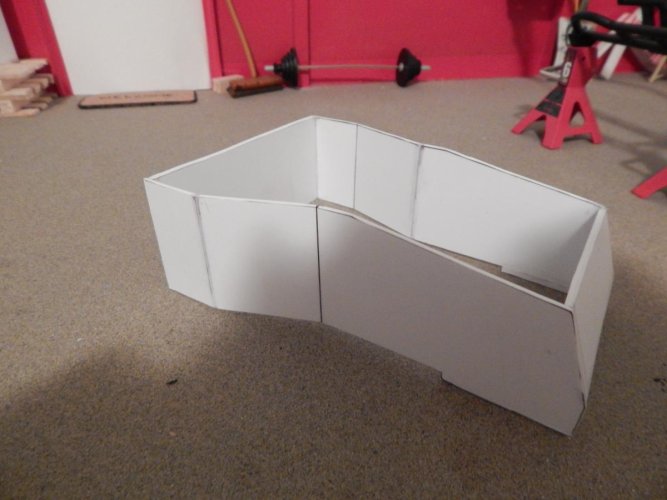

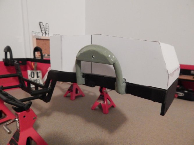

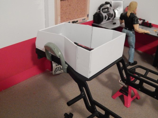

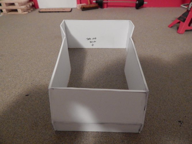

Also used some styrene to make a box to hide the electronics and get more of that scale look.

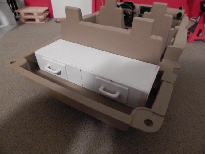

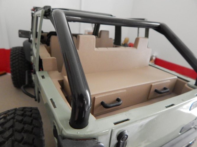

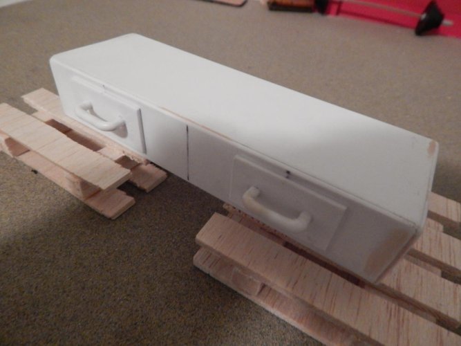

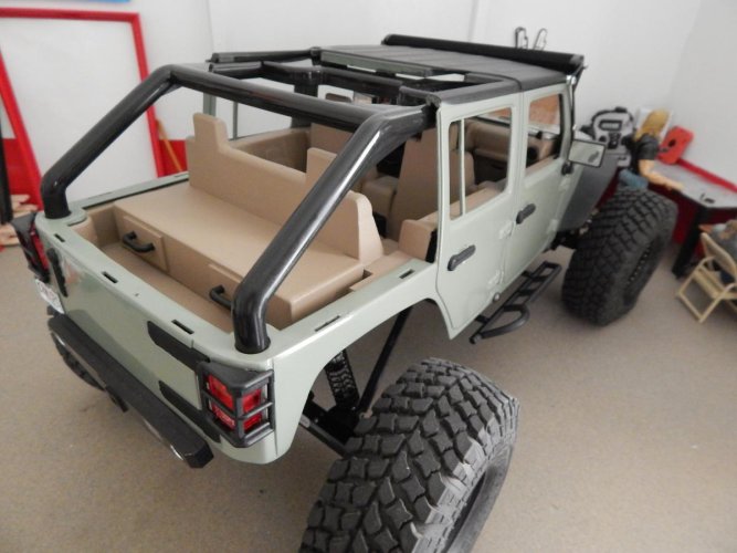

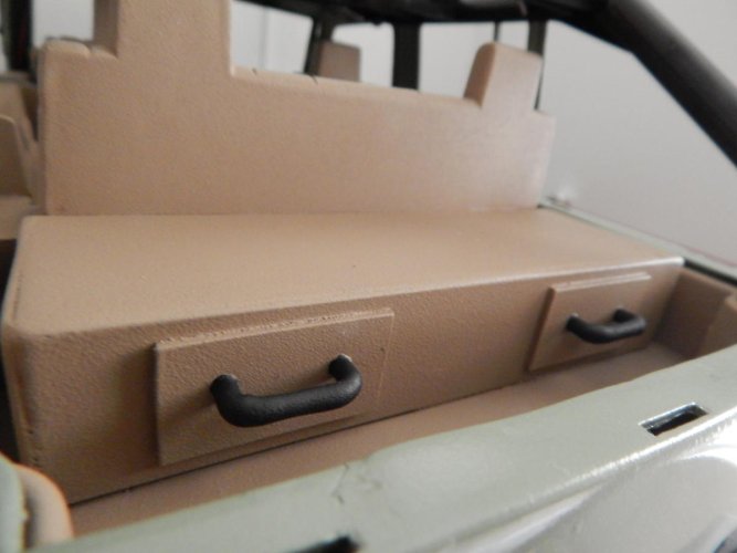

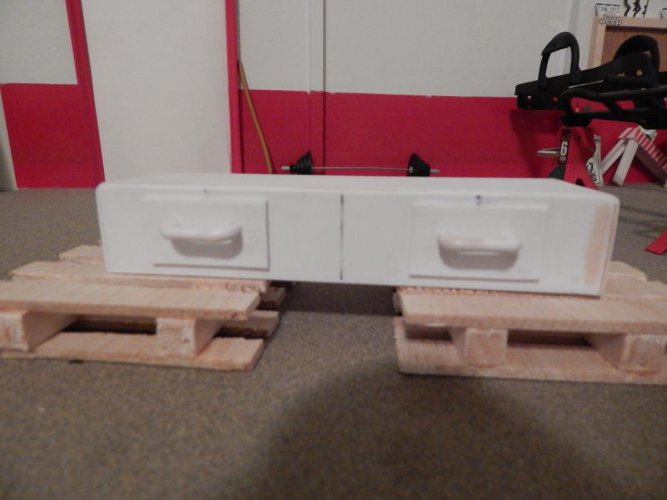

Decided to make the trunk box into a storage container with drawers.

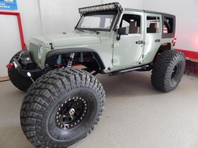

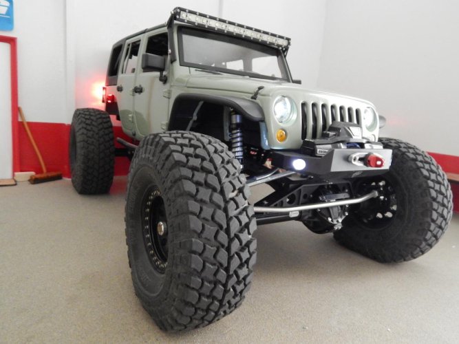

Finished! Just a few finishing details and I need to take it out for a maiden run and see if there are any mechanical issues.

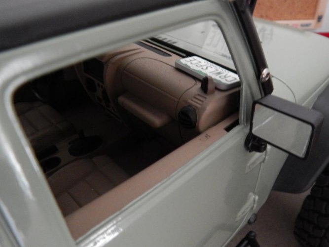

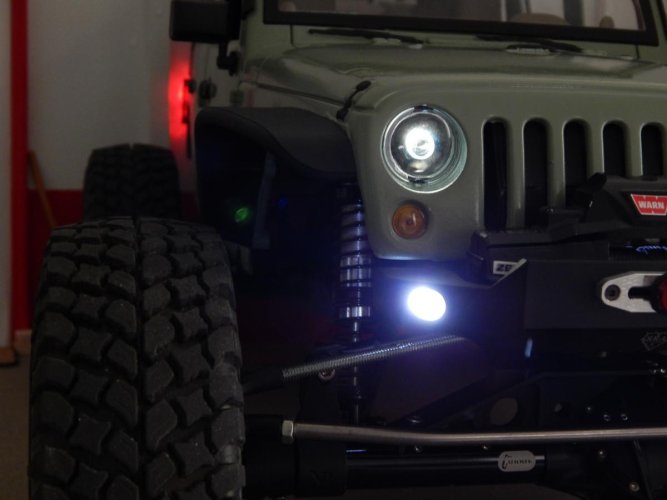

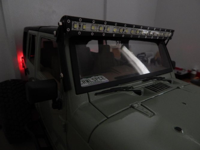

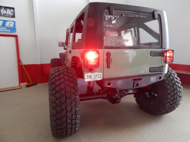

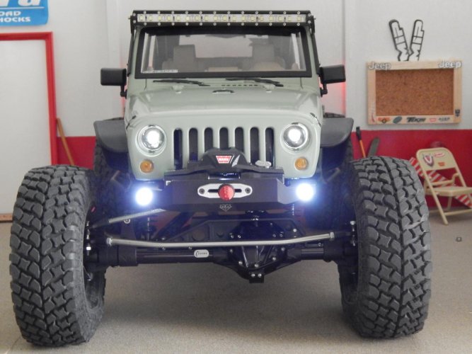

Interior. Also got halos installed in the headlights.

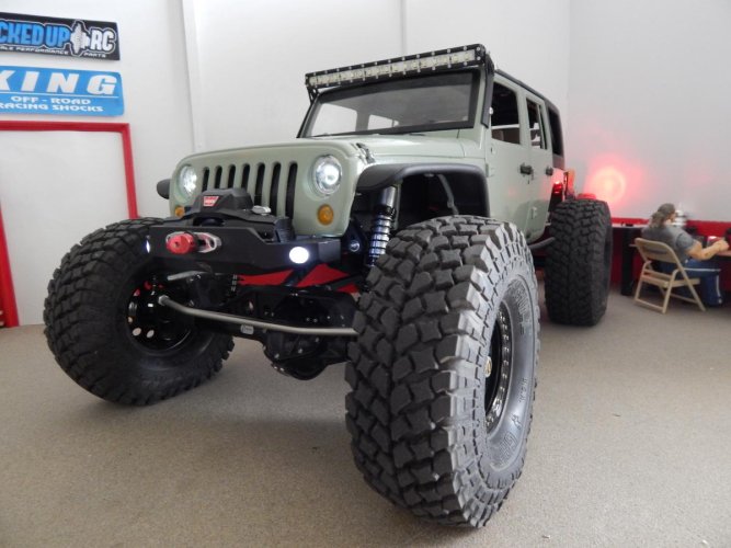

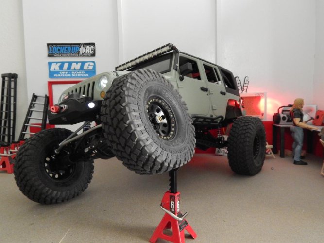

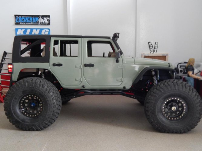

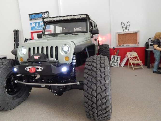

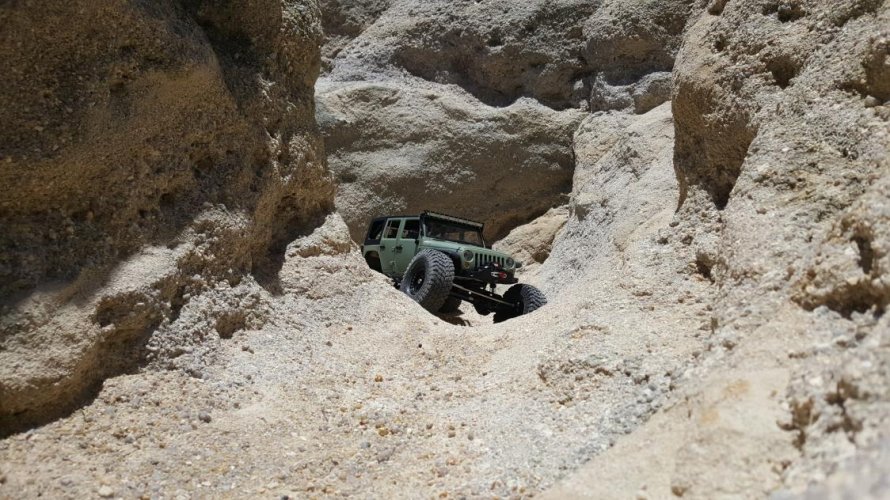

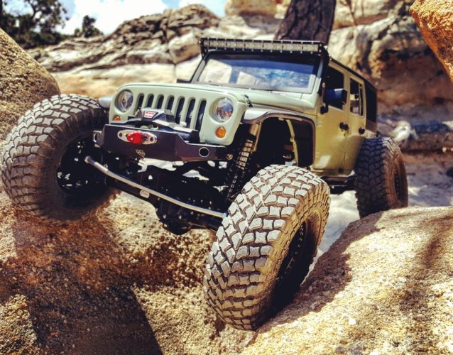

Heres a few shots from the maiden run yesterday. Need to do a couple of adjustments and The Pale JK is solid
Looks great dude. I am also a fan of the paint color.
Have you noticed any adverse affects from the forward angle of the rear shocks?
