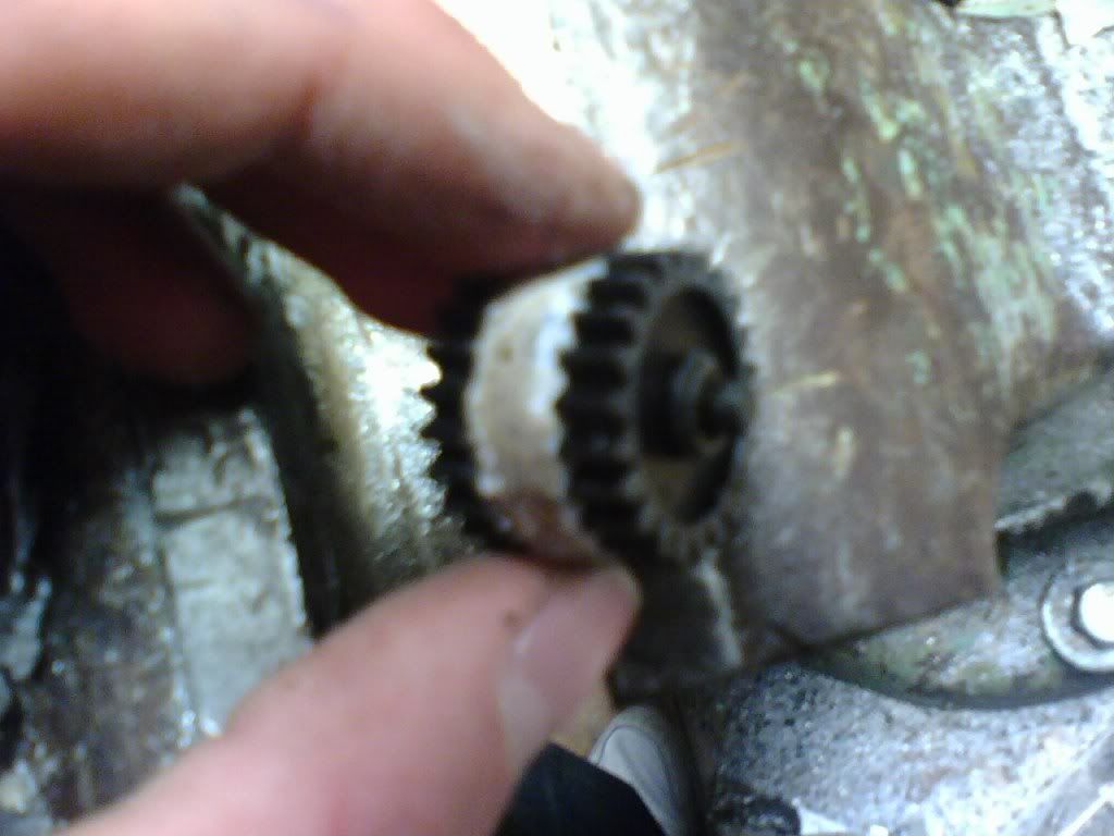

WK Tranny Fix
I tryed to fix my tranny with the screws, but lost part of it in the process;-). This worked to my advantage though. I just took out some JB Weld and packed the thing with it:ror: But still made sure not to get it on any of the gears. The jb Weld is still doing great up to now, and I highly recommend it, if you don't want to put in the screws
sorry for the big picture

I havent had any clicking put I just put my crawler conversion and a novak brushless 13.5 in it. I took it outside set it down and the spur and pinion are spinning like hell and the truck is not moving. Its something in the tranny. I have 5 other RC's but none are set up like this. Is it that little gear with the spring on it? Will this fix work for it? Thanks.
There are no stripped out gears but I do not understand how this little spring doodad works. Are you supposed to be able to freely spin one side while holding the other side still? Is it time for me to buy some jbweld?
There aren't any broken teeth on any of the gears? I dont understand how this little spring thingy works though. Should I drill holes in the slipper and screw it to the other disc or put some JBweld inbetween the two little gears with the spring in the middle or both?
Look closely at the parts-something isn't right. Post a pic of the parts if you can, maybe there's something you don't "see" there...

I took apart the little 20 gear slipper deal with the spring and the inside of the gear and the slipper piece were ground down perfectly smooth. I put gorilla glue on them and then put 2 screws through them. Seems to be working fine.
