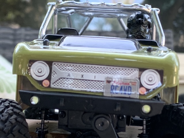

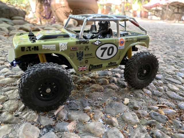

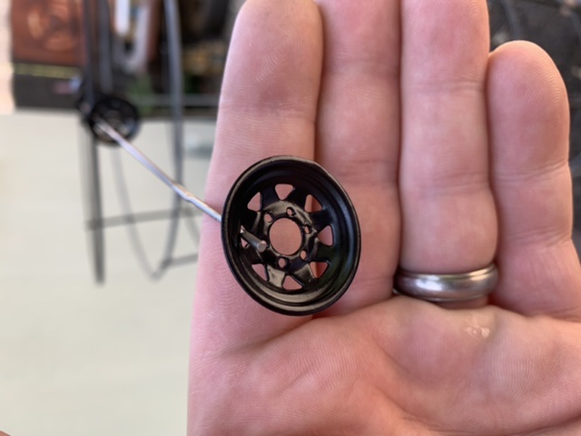

Done a few things off of this thread to her. I thought I would share my build with y’all. Old man emu shocks (Droop set up with no springs, until I can find soft enough for Droop), 3mm wheel spacers & relocated electronics…But will be installing a castle esc and maybe a 380 revolver (weeeevolver!) soon. Have the RC4WD scrambler tires coming in a couple days. Also, four wraps of golf club lead tape around each inner wheel. (I know, I know, rotational mass!) And they were out of black wheels, so I made (painted) them myself! This is really a fun little rig!

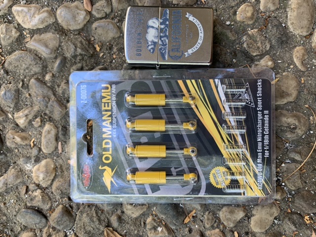

Are those shocks meant to hold oil, or is it internal springs only?

I haven’t done the front mount yet. They are designed to hold oil, but I am running them sans Springs and just a couple drops of oil for lubrication. Not dampening. ($35 for all four with different springs)
Does it give a recommended oil weight? They seem like infernally spring friction shocks, not oil shocks meant to hold oil like the carisma MSA1-E shocks. Does it have internal baffles to control oil? It would be interesting to have a second oil shock option, but I would have expected them to mention it in the description.

They’re completely sealed and are exactly like the 10th scale old man emu internally. To be safe though, if I were to completely fill them I would run them upside down. Like how they measure travel distance without the internal spring. Sometimes their descriptions aren’t thought out very well. Now I can’t remember whether the internal washer has holes or not… ? i’ll have to look later.
