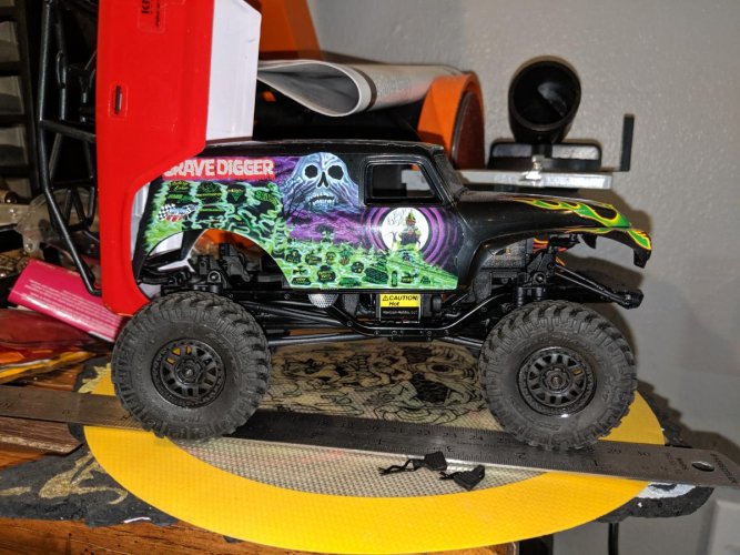

I'm thinking about ways to lighten up the Toyota body. I may cut the bed and just leave the bed sides or "Truggie" it and 3d print a back cage. I think I may get another just to put this body on, I've had it in my cart for 3 days already lol
The basic parts to make the Toyota body weigh 2.1 oz and the stock (read highly modded) body weighs .9 oz (I've trimmed a bit off the body on all sides, trimmed and simplified the cage a ton so I'm not sure where the stock body sits, maybe 1.3 or 1.4 oz?)
First thing I pulled off the shelf to test..... Choosing what body is going to be fun
