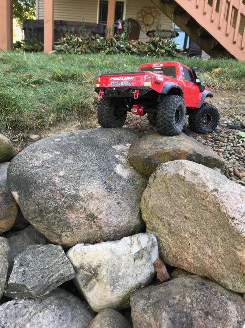

Having already flipped the bumper mount on the chassis, It dawned on me to also flip the brackets on the bumper itself. Gained about another 1/8" of departure clearance."thumbsup"
I got out for some more test and tune with the new powerplant as well. As I mentioned earlier, I'm ditching the full coverage bumper in favor of a small coverage stinger for better approach. So on my test today, I just ran without the front bumper and what a huge difference! If the stinger eliminates even half as much hangup I'll be thrilled.
I think I've got the 1800kv Revolver completely dialed for the Sporto now. Throttle curve is awesome, and the drag brake is spot on. It's like a whole new truck. Threw the OG body on and just went out and thrashed it. Just so darn capable. I'm falling in love all over again!:lmao:
New body is in route, and the new "shoes" and foams should be here Friday. Once I get everything set-up, I'm gonna get out to some rock ledges that are about 20 mins up the road from me. Scenery and terrain are epic and every time I go I ask myself why I don't hit it more often. I'll be sure to post some pics."thumbsup"

I took the bumpers off my rover to fit my Raptor body and it makes a massive difference. Only issue is now the body is more easily damagable. But if it's a crap body you don't care about, go for it!
Agreed. If I'm running the old Sport body and I know it's gonna be technical, I'll just run without. "thumbsup"
