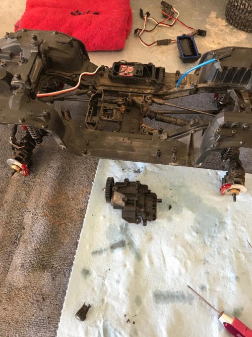

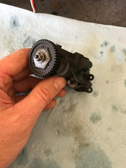

Gave the Sporto some much need love and maintenance today. Completely broke down and cleaned the shocks, fresh oil. Cleaned and greased the ring and pinions. Blew apart the trans for a thorough cleaning and inspection and some fresh grease. Cleaned / greased portals. Then, a nice dry brushing and hit with the air nozzle over the entire chassis to get all the grit off. Should be ready to roll.

How are the guts holding up? Any wear?

Hey smog.
Internals were absolutely perfect and this rig has been driven hard and put away wet. It's definitely seen more water than most of my rigs. That was one of the driving reasons behind the tear down and inspection. The grease was a bit broken down and a tad dingy, but nothing major and no shavings in anything.

Hey smog.

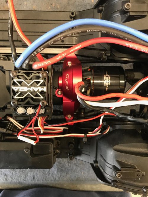

Welp, after sleeping on it, I went ahead and did it. As I mentioned earlier, I didn't want to cannibalize the custom, Wraith based rig that I had the Mamba and Revolver sitting in. But, after a few clearance and lead length checks this morning, I determined I'd be able to throw the 550 and HW 1080 out of the Sporto in to it and keep both rigs up and running. Winning!"thumbsup"
I've got to play with a bunch of settings and get a baseline for the Mamba and Revolver in the Sporto now though. I took it out with the settings I had programmed in for the 2.2 Wraith based rigs and there just way off for the Sporto. But, the slow creep and resolution is fantastic. I'm gonna pop over to the Electronics thread and see if JRH can suggest some good baseline settings based on my gearing, voltage, etc.
I noticed that the GPM spur cover has a little projection where the motor shaft sticks out. Was that enough to clear the shaft? I needed to use all three of the set of YR spacers on my GRC one piece cover even though it has a bit of extra space there as well.
I could have trimmed the shaft but I figured the spacers moved the motor forward 3mm to help the CoG, even just a tiny bit. The leads on my Revolver were still just long enough to reach the ESC without using an extension though.

@bbrigg - Unfortunately, I still had to trim the shaft about 4mm. Not a massive amount and still plenty of ability to move a pinion fore and aft if I ever move it to another rig.

After re-vamping the Mamba settings for the Sporto, I did a quick shakedown run when I got home today. Extremely pleased with this set up in this rig now. (Mamba-X & 1800kv Revolver). You can creep so damn slow but pop the throttle and the wheel speed is there. It definitely has a different feel in the TRX than it did in the 2.2 Wraith based build. I'll say it again, the best addition to Castle firmware has got to be the drag brake ramp feature.
