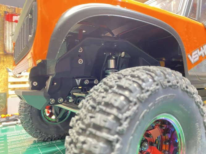

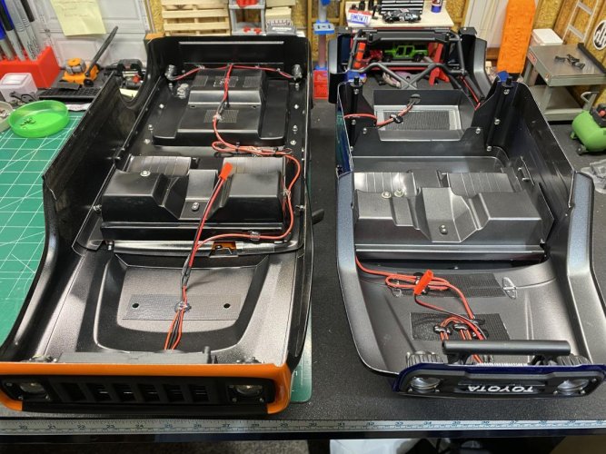

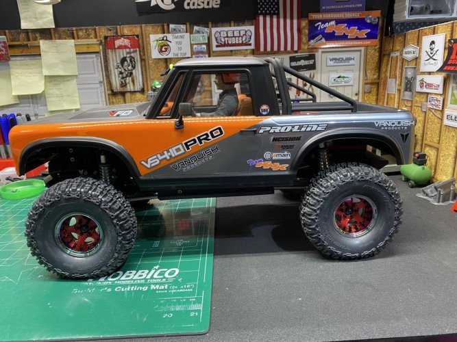

Hey, I'll try to snap a picture of my PRO body on my Phoenix chassis to see how the inner fenders work with the Half-cab body later today.
Any idea if the Phoenix fenders will jive with the Pro body? How about using the Pro/Ultra half-cab on the Phoenix chassis?
Here are a few pics of my PRO Half-cab on my Phoenix. I couldn't sit the body down all the way because the interiors are slightly different. The Phoenix interior has a "bump" in the driver side floor board for the OD servo as seen in the pic below.
It looks like the Phoenix inner fenders will fit inside the Half-cab body OK. As seen in the pic below, the sliders would have to be changed to the PRO sliders in order for the body to fit into the sliders.
