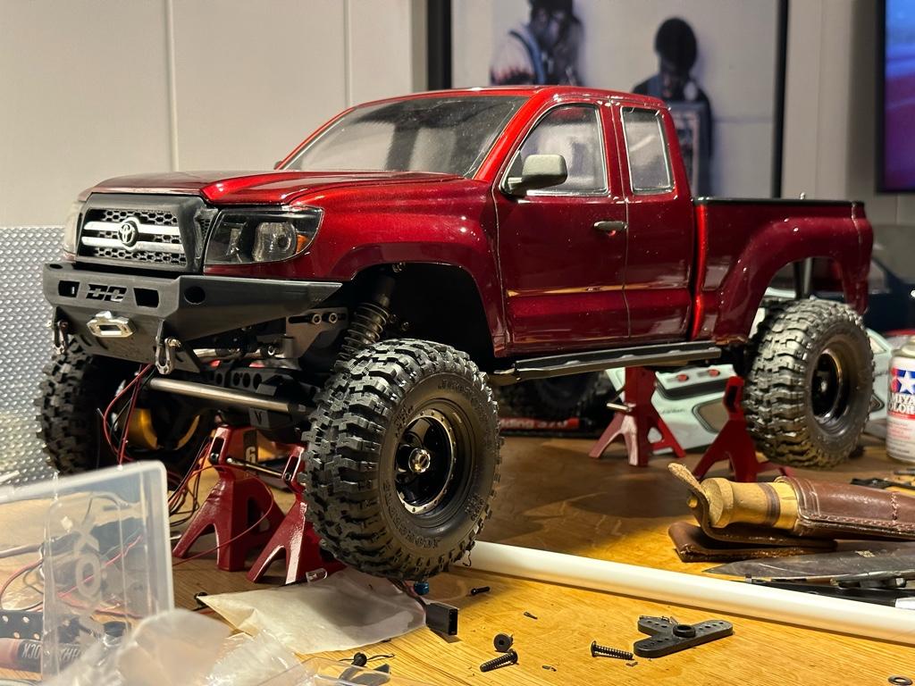

Update: slow cook on this one, but I've got some stuff done.
First: got the body painted. Translucent red over Bright Gun Metal, backed with black. Candypaint for rock crawling?! Yes, mom.
Made a floor/slider piece out of sheet styrene and a piece of a TRX-4 part. Then made some front inner fenders out of EVA foam.
The grille is just sanded. Aluminum tape is still a hero in this hobby.
Used Kyosho Micron tape for panel lines, it's really freakin good for that. Love these headlights!

Finished my homemade sliders and inner fenders, got the Phoenix interior painted up and paired with a LC70 dash.. hybrid moments.
My homie is printing a rear bumper and I'm still thinking about fender flares. Salut!
That's a damn fine-looking rig ya got there, man!
Gorgeous red paint, killer wheel and tire selection on the last pic.
Grille and bumper are SO clean..."thumbsup"

Thanks man! Hoping it'll be all sewed up this weekend
