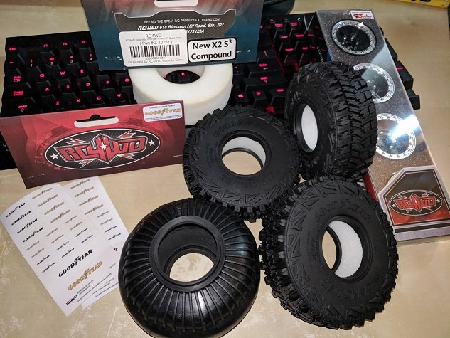

I really like the RC4WD MT/R's just wish they were slightly taller, about 4.5 inch like the old Vaterra swampers. I don't know what terrain you drive on, but they work well in my wet, muddy, mossy stuff.
I hear ya, but they went with 4.19" C-1 legal size for the one set and then maxed out the others at 4.75" for those wanting to roll over whatever's in their path! As well as making them in 1.55", 1.7", 1.9", and 2.2" wheel sizes...
I think they've made more sizes total of this tire than any other mfg has made of any other tire design.
And, I gotta say with the new very nice and sticky X2S3 compound, the sidewall ribbing and stiffer foam - RC4WD really seems to be trying to outdo themselves with this tire.
As I may have mentioned before - I am in a very dry, rocky, gravelly, and dusty terrain for the most part... and hoping they work well for me.
I'll be needing to pick my lines and increase my throttle control to make it up some places the taller stock tires did, but my tires are soaking in Purple Power as we speak to remove mold release and make them as sticky as possible!

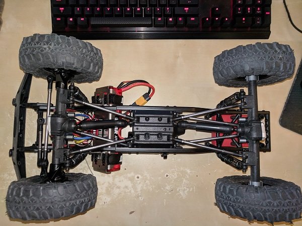

Hmmm...I was getting ready to try mounting the steering server on top of the mount instead of under. Not so hot, eh?
Nope... were you going to rotate it or leave it in the same spot, just on top? Don't think that's quite as bad, just elevating it - but it still induces some extra bump-steer...
After rotating mine 90deg - making it in-line to the direction of travel (frankly, I did that to be able to put the ESC mount next to the servo) I swapped my servo horn for a new Vanquish I had reserved for the Bomber to clear the drag link on compression of the suspension, but it still was awful... read the manual for the kit (instead of for the K10, which strangely shows the servo mounted the 90deg way, not transversely as it comes built?) and it mentioned the recommended servo location for shorter WB was in fact transverse. That's why I changed it back, it drove so terribly when setup the other way.

It's relatively simple to change it one way and then back, if I were you I'd make a note of turning circle and suspension travel as is, then after changing it to above the mounts. It may be worth a slight change in steering for the added travel, but I just preferred it as is. The new servo I put in works well, and the radio too... so far I have no complaint's about a little less front travel.
Too funny, I was loading tiny washers to try and lengthen mine, ran out!
85mm eye to eye. :ror: ;-) :) I dug in my spares box and used Axial 55mm green aluminum link with Traxxas Stampede ball ends.
One thing about re-entering the hobby of R/C - I have no spares... Anyways, I'm fine staying as I am, now that everything is servo-taped, I'd hate to unstick it all!
