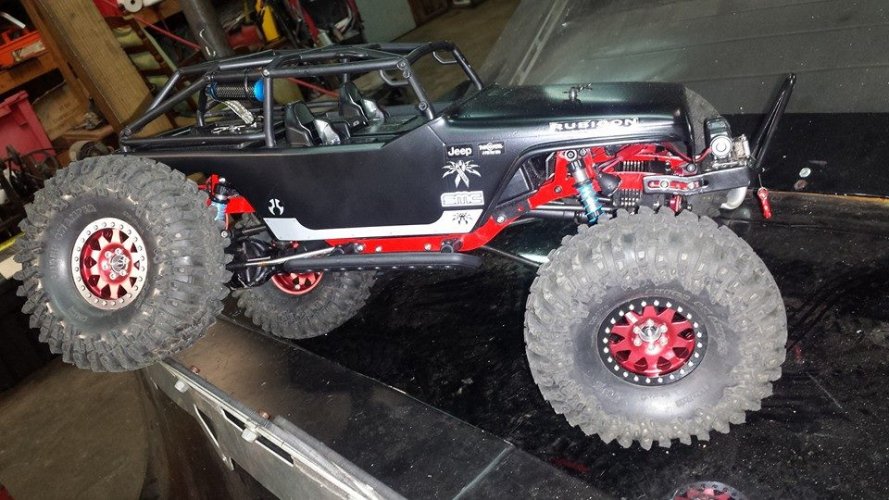

Here is my Wroncho build using the SCXHR chassis and skid.

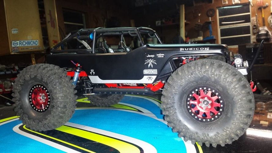

Here's mine 99% done.
Started this months ago and finally got it finished. Still waiting on new springs to tune the ride height. But it's awesome.
