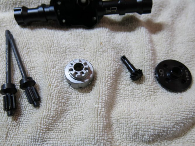

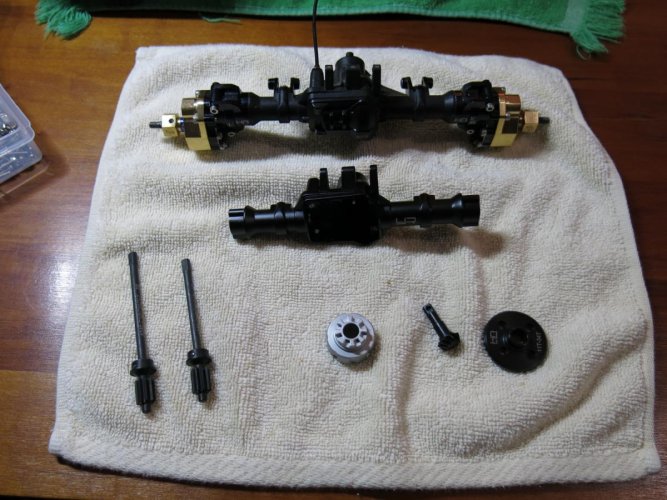

so my Honey Comp Crawler Rig is doing great super capable and I finally installed the Hot Racing Differential Gears Overdrive front and stock in the back and its amazing and I went ahead and installed these heavy duty portal drive gears and on the first run the rig had a lot of trouble getting up what was normally something easy and felt like it was slipping!!!!
ANYBODY come across this????
For Sure its these portal gear shafts are what has made the rig now weak so im goin to go back to the heavy duty driveshafts and protal gears I had before....

So I did another test run before heading to the rocks and the rig is still running a little funny WITH THE TRAXXAAS OUTPUT GEARS AND SHAFTS but is handling and pulling a lot better than the first run and probably the gears need a couple hours of breaking in as the front was a little rough when installed the overdrive gear and after 2 hrs of climbing it was very smooth when turning the wheels!!!!

I'm not sure I understand your issue. These are gears, there is nothing in there to "slip".
I agree, I read through this earlier and dont understand either. Were you driving with open diffs and didn't realize it?
Can you clarify whats going on or take a video?
Hey everybody thanks for the the comments first of all I slipped when I used the word slipped I should have said it was acting like the gears were loose but that day I don't know if I was stoned but the Rig that is so functional that day I tried it was just slacking big time and basically not giving me much torque and yes the diffs were locked so went back checked everything all looked good and then tried the Rig out again and voila magic running better than ever!!! Now im not sure but tell me if this is correct the beveled Hot Racing Diff gears
front and rear I installed were not spinning smoothly with unlocked diffs but after a couple runs they are smooth! so I guess my question is do the gears need a break-in period????

Diff gears dont really need a break in but sometimes they benefit from being run, this in my eyes has more to do with fully seating the gears/bearings. I often chuck up a drill to the output shaft on newly built axles and run them for a little bit to fully seat things.
If you do have issues with the diff gear meshing nicely you can shim the diff. I do this on almost all of my rigs as most have side to side play on the ring gear and in out play on the pinion (though on some rigs like the SCX10.2 hooking up the driveshaft fixes that).

HumboldtEF. Thanks for all the good RCshop advice and yes those gears could have used a couple spins on that drill for sure and you are dead on with conditions changing everything I think its because here in Nashville weather goes up and down like crazy and I think moisture humidity was an issue that dy! but the gears for sure were not smooth like they are now after 3 good runs...

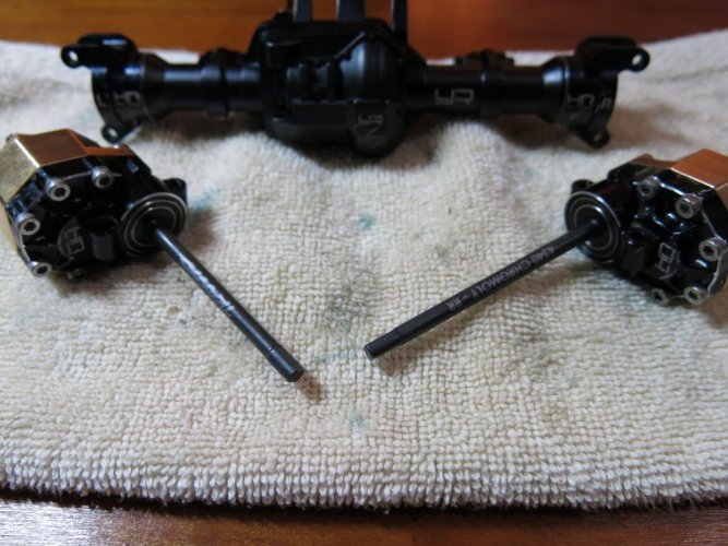

the only thing I was little weirded out by was when I installed the Traxxas input portal gears and shafts to both front and back before installing into axle housing I spun the stub axles to feel the smoothness and the shafts wobbled a lot that concerned me I might have a slight bend on one of those axle shafts???? BUZZZZZZ...... ALOHA.......
