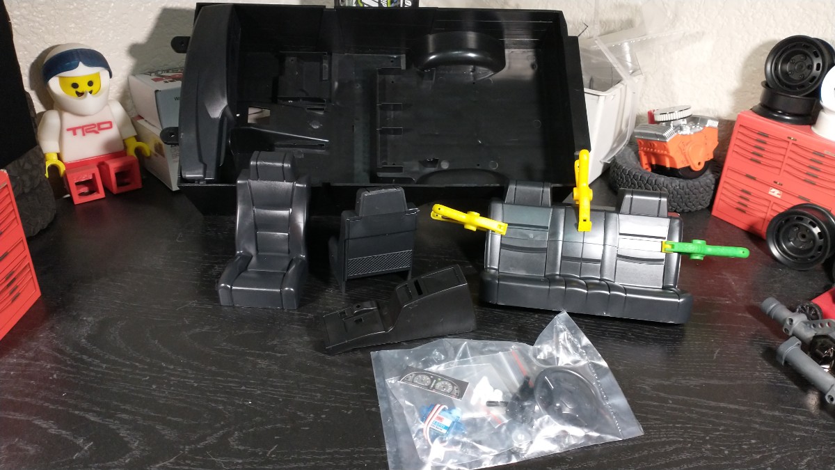

Interior came in. Like the window visors and spare tire mount, the interior fits the body perfectly. As for making this mesh with the TRX4 chassis, it's gonna take a bit of cutting and trimming here and there. I want to utilize the Traxxas inner fenders still since the rear shocks mount into them, so I will trim the interior portion away as needed, and under the center console area to make space for the battery.
I still want to run a 5000mah in it so the battery may interfere with the lower part of the rear bench seat. I'll trim part of away if needed and also seems like the inner sides of the front seats may need some trimming away as well. Once I have the battery shape in the interior, I'll build a styrene boxed piece to hide the battery. I'm unsure if I want to keep a black interior (in 1:1 life, we all like a clean black interior right?), but part of me wants to do a tan or light gray because the contrast it will give to see the interior easier would be nice.
Also in this interior kit, I had no idea I was getting a servo powered steering wheel! I'm gonna do my best to make that work. As this build gets a bit more detailed, I feel like having a servo powered steering wheel but no working head and taillights is just off putting. So I might do a light kit...

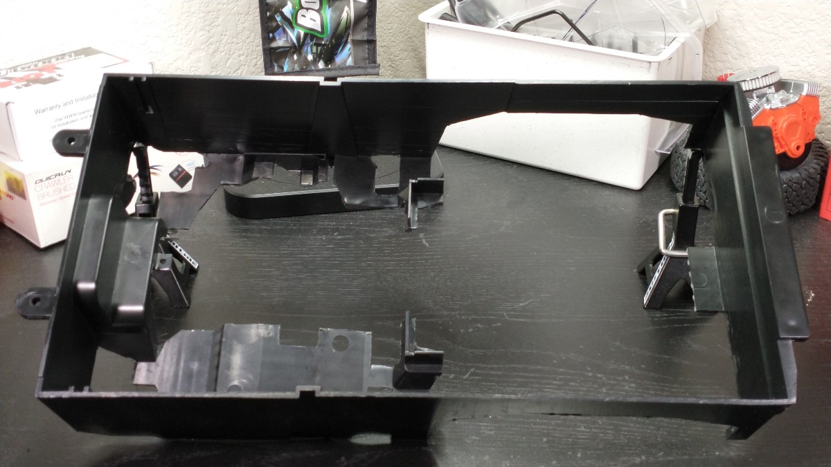

Interior update time. I have all day on the Memorial Day to finish this. I also want to work on my KR as received the tonneau cover for it! But as for this rig's interior I'm probably 75% complete including fitting the steering wheel servo to operate. A lot of trimming and fitting, x over9000. Because of the excessive trimming, I'm sticking with a black interior but I will end up painting a black of some sort.
Comparison of before and after the hacked up interior:
So in order to run this interior in the TRX4 without disrupting the appearance too much, I began with moving the ESC and receiver to the winch servo tray area. Then the diff servos needed repositioning, so I simply laid them down with the stock mount and used 2 screws with nuts to secure it to the slider floor/tray. It's not as secure as it's original position, but I'm hopeful it will be good enough.
Switched from a 5000mah hard pack to a 3200mah softy. I need about 1/4" shorter in height to mount the center console like stock but I'm calling it good enough. Once everything is ready to be glued in position, I'll cut up some styrene cover the battery completely, and finish putting a rear floor back in with styrene as well.
