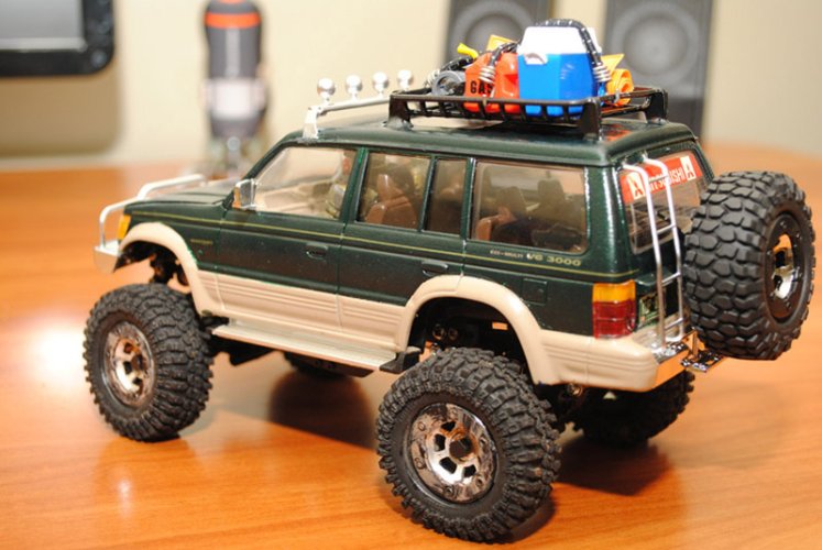

Here are my build links
Chassis $42.97 BLADE SMC 4.5 EX
BLADE SMC 4.5 EX [SMC4.5] - $42.89 : Crawler X, Rock Crawler Parts
Body $42.99 Tamiya '93 Mitsubishi Montero with Sport Options bought at local hobby shop[/COLOR]
Wheel Weights 4 for $6.99
Search - LOSB1588 | Horizon Hobby - Radio Control R/C Planes, RC Airplanes, RC Helis and Helicopters, RC Cars, RC Trucks, RC Truggys, RC Boats, RC Radios, RC Engines, parts, hop-ups, and accessories
Tires 4 for $13.99 RC4WD Rock Crusher Micro Crawler Tires
RC4WD Rock Crusher Micro Crawler Tires (2)
Wheel Wideners $9.97
MICRO Wheel Widener Kit [MWW001] - $9.97 : Crawler X, Rock Crawler Parts
Skid Plate $8.87 Aluminum Silver
Micro Center skid plate Aluminum Silver [MCC13308] - $8.87 : Crawler X, Rock Crawler Parts
TOTAL COST: $125.78

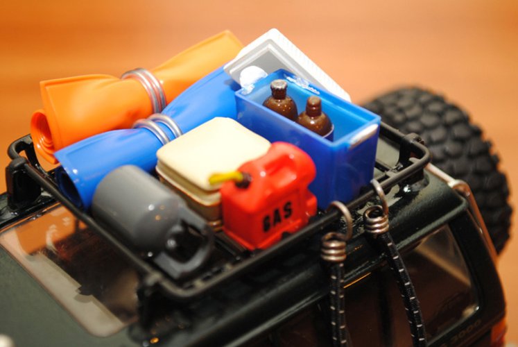

Here are a few pics... The paint is not perfect and I had to glob on the glue for certain parts but I wanted it to be functional not just pretty.
Hope you all like it and feel free to comment!

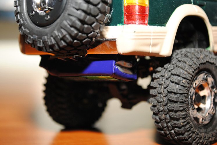

Yep, I agree. You all beat me to it :ror:
I am working on some bent links for the front and will bend the links in the back for a total of 4 links. There isn't enough room for 4 in front and 4 in back even if i wanted to.
I'm also trying to soften the suspension. Possibly taking out the leafs and putting some shocks in???:???: I'm not sure... any thoughts??
Shocks are extremely long and you would lose your scale height. that and you would have to run a 4 link. you might want to experiment with a 4 link and springs? http://www.scale4x4rc.org/forums/attachment.php?attachmentid=76848&stc=1&d=1314149588
