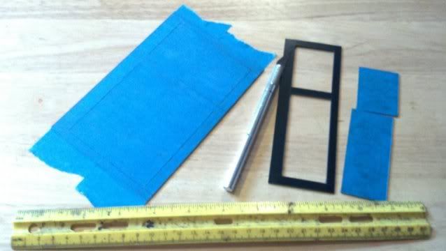

Cutting out the logo

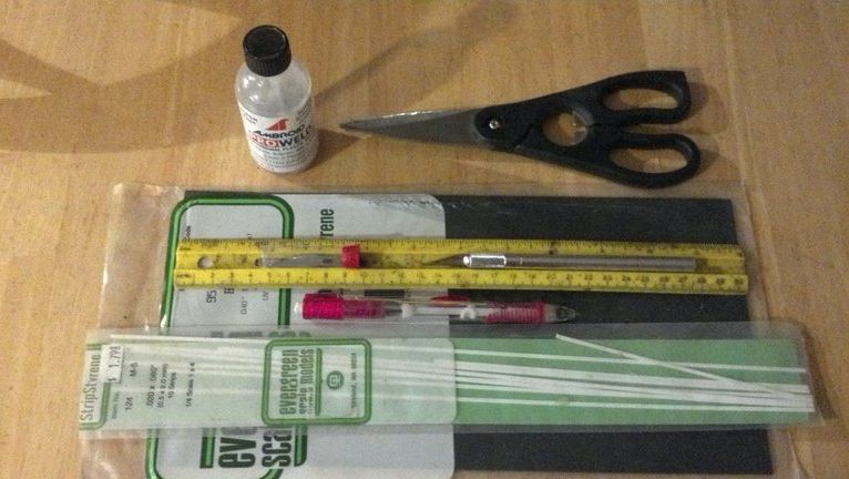

here's a pic of materials and all of the tools that I will be using. the materials will consist of .040"/1mm thick sheet styrene (black) and .020"/.5mmx.080"/2mm strip styrene (white). the tools of choice for this build are a 12' ruler, hobby knife w/#11 blade, an ambroid pro weld- plasti weld. (scissors are there for support):lmao:
*Note* there is no putty or sanding tools pictured or listed. they will not be used nor needed in the build of my box.

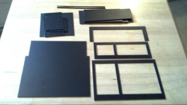

I did however, get a lil bit of time to start on this project yesterday evening before I had to be at work. got most of all of the major pieces cut.
i'm gonna attempt to build a roll cabinet w/top chest. will be about a 5' scale cabinet.

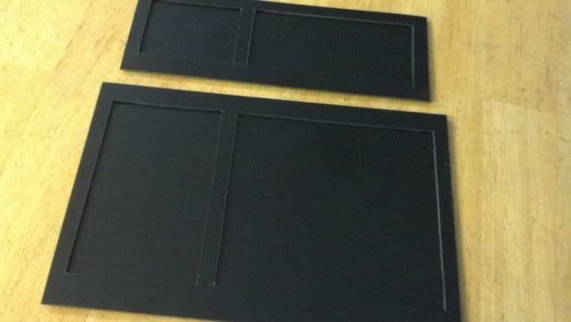

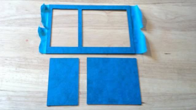

I started by laying out my 2 front face plates, and getting them cut out. all my cuts will be made using the ruler as a straight edge, and scoring the styrene w/the hobby knife, and then just "snap it" apart. sorta like cutting glass. this method gives you nice crisp edges.
I then cut some pieces to put behind these face plates. this will give it depth and look more realistic.

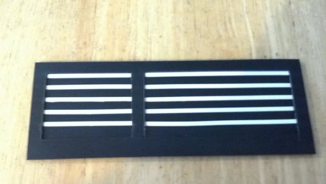

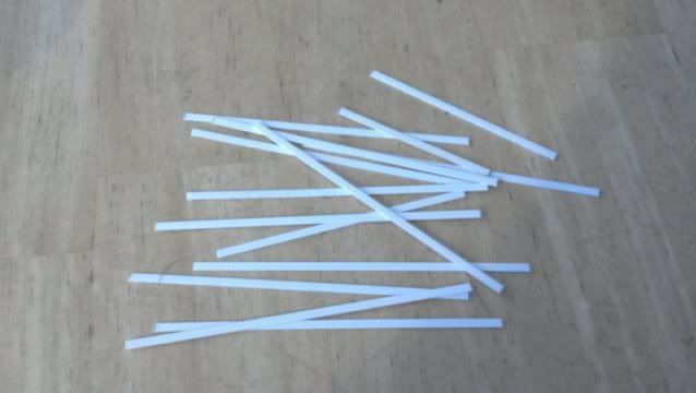

i first measured and cut the white styrene strips to length, which will be the drawer edges/pulls.
then of course, i got them attached to the face plates with the pro-weld.

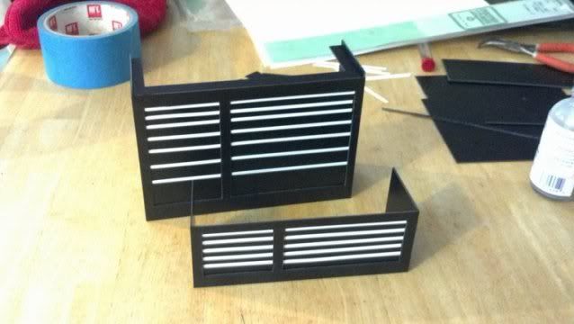

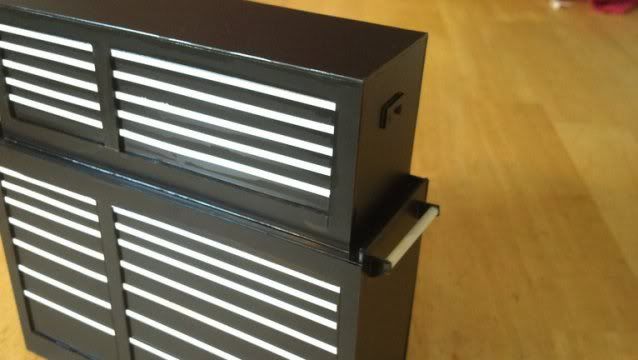

anyway, here's a pic of th boxes themselves completely assembled.

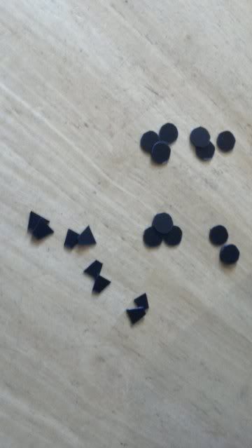

i also took a quick few minutes to cut/make some somewhat ok handles for both boxes.

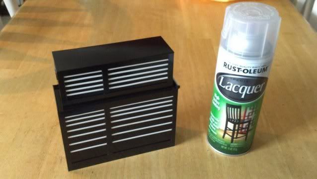

my biggest worry with not being able to complete this project is paint. i have a plan though, i just hope that a couple coats of high gloss lacquer clear will be considered paint:ror:. i do however have a lil detail trick that i'll reveal tomorrow with the final pic.

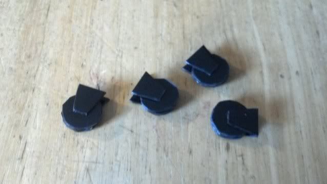

i do still have to make some casters for it. hopefully that will be the only thing left, and i can knock them out in the morning after work.
